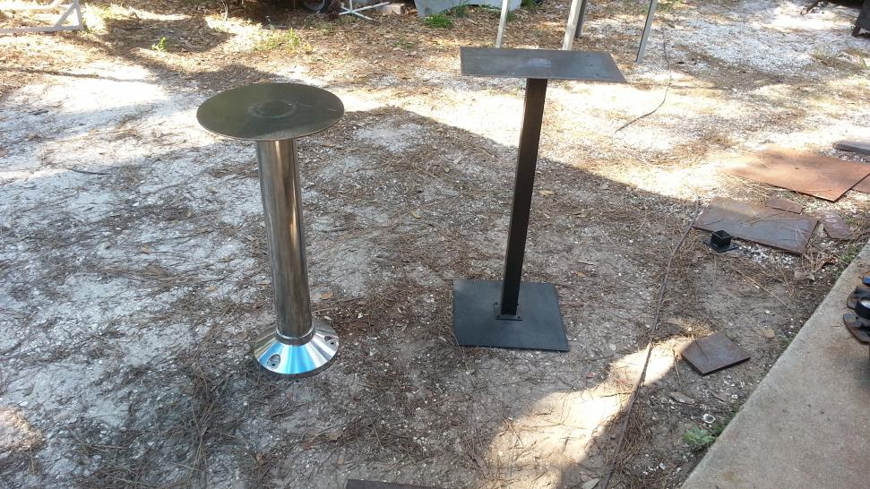

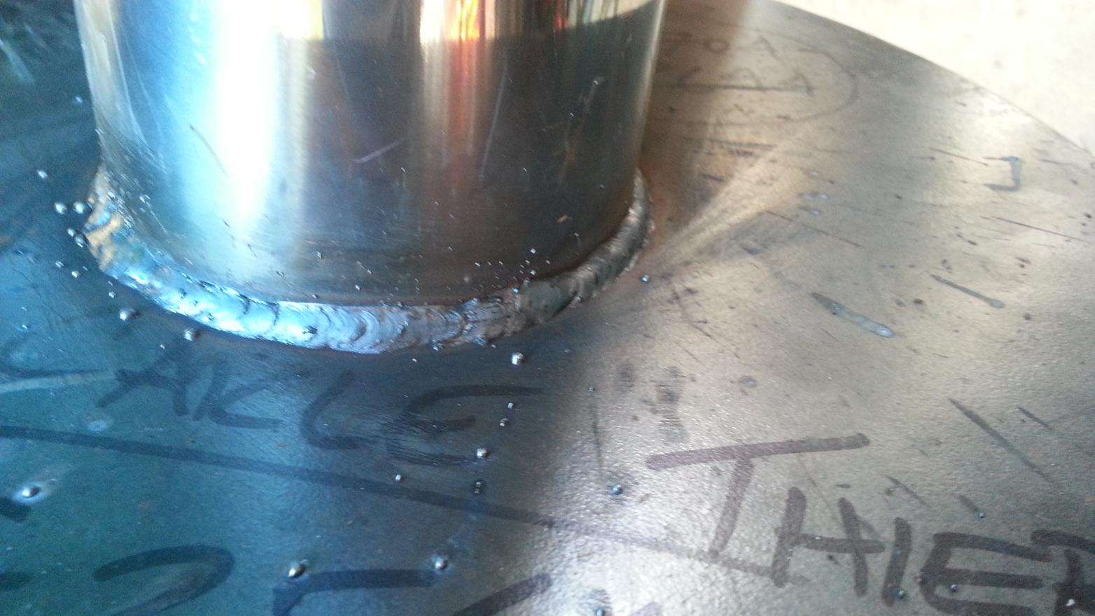

Nothing special here. A fellow brought two bases and two tops, One I had to cut a pipe off of. It is for him to display his metal art. A couple pictures. All MIG with Everlast IMIG-250P with ER70-6, 21 volts and about 200 on the wire-feed speed. Was outside and it was windy, as you can see the spatter.
Round one

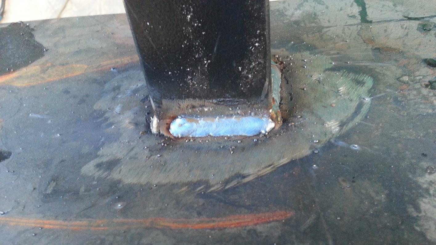

Square one, non cleaned up or painted .

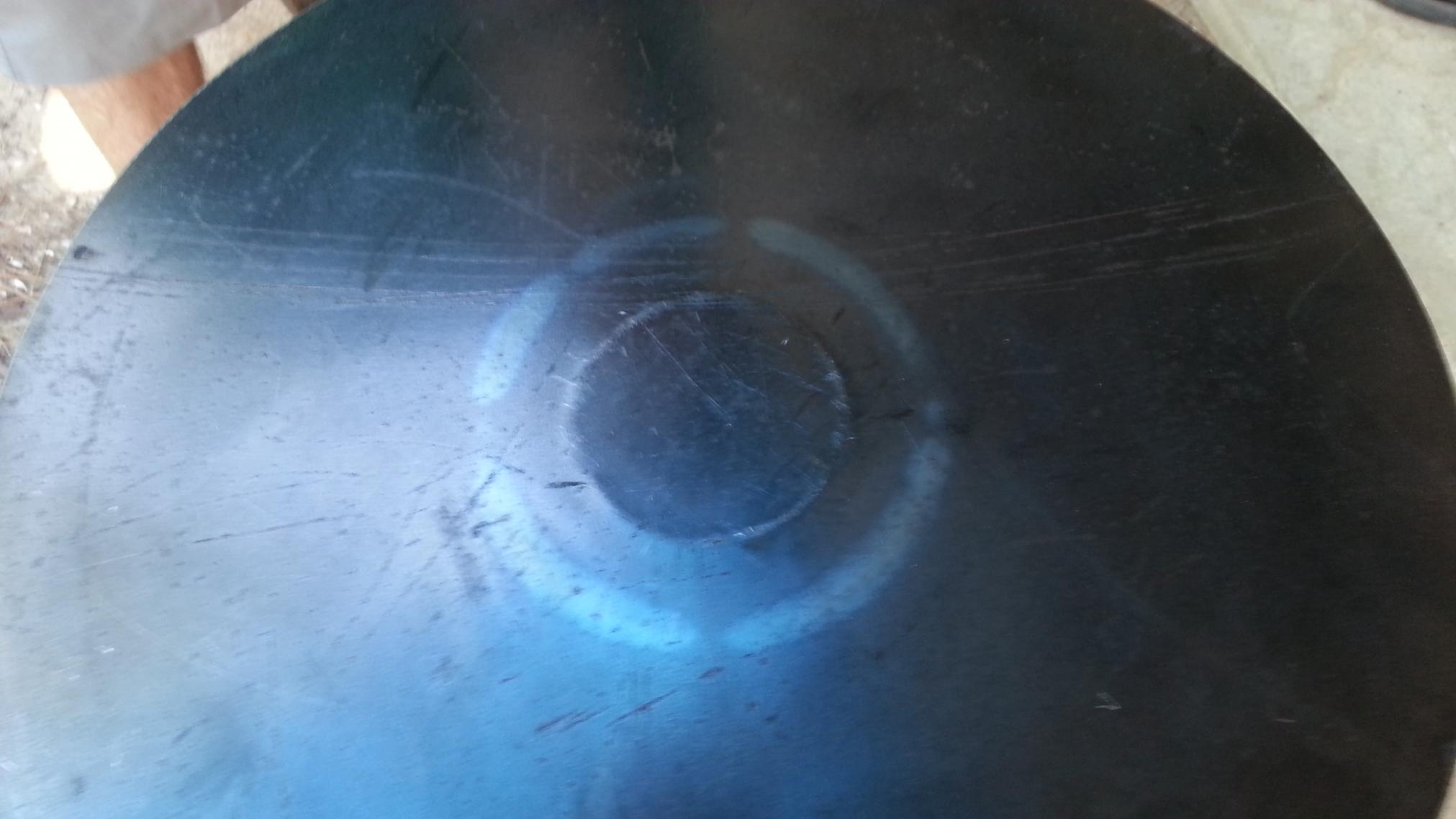

Penetration, mine is outer one. It had a pipe welder to it same and the squared one.

Final product.
