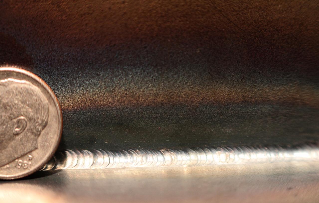

    Started laying down some small beads today, thought I would share some pictures of em'...a dime is placed for referanceClick image for larger version.
ID:	9579. I was right around 70amps. I'd love to see more of whats is out there - Ryan

    Very cool, nicely done. Are you experimenting with small beads or is that part of something else?

    My instructor kept telling me to scale it down... after some experimenting I welded that piece. I think he is trying to get us ready for stainless. My new machine will be here in a week or so and I can't wait to see how well it preforms against a dynasty 350. I know it's kinda unfair, but I have good hopes My Micro 185 had a really nice arc and I'm guessing the 250ex will be better. I'll be posting lots of shots of my welds from the 250ex

    70 amps? How thick is the base metal?
    I was thinking of running some more blades this weekend, I like to play with them every couple weeks. Believe it or not, I find it a really good exercise to keep close control of the torch... yeah, you can practice on big stuff, but a bit of wiggle or varying arc length don't really show as easily as welding up .009 thick razor blades. I usually set the machine around 10A and pedal my way around.
    Bead is a bit tall, only had 1/16 filler on hand that day. Penetration is great, through and through. Bit of warping towards the end, I just set them on the table, no clamp or third hand (though I built some since then)

    It was on 14 gauge......074" so 70 amps was on the lower end. The razor blade thing is great...gotta try that soon. And yes the Micro 185 WAS a good machine but sold it to help fund my 250ex. That should keep me busy for awhile I'll give the razors a go in a week when my new machine gets here.

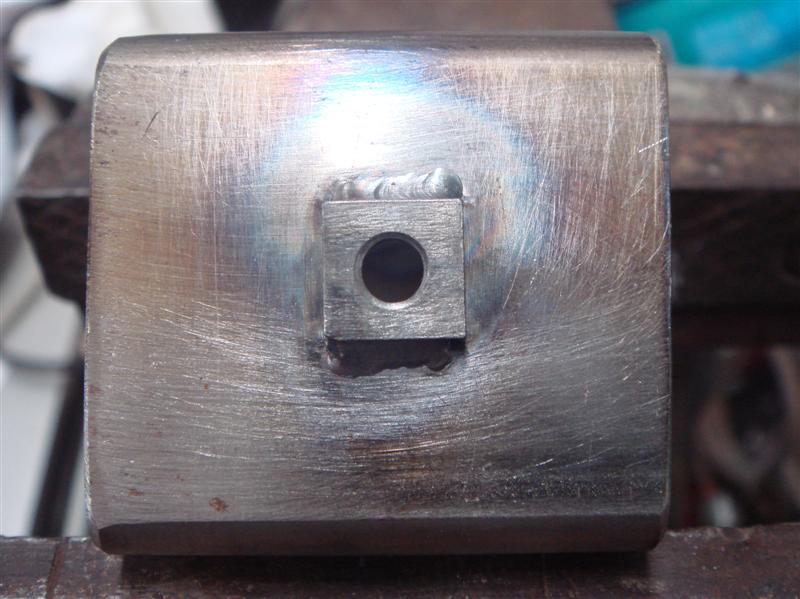

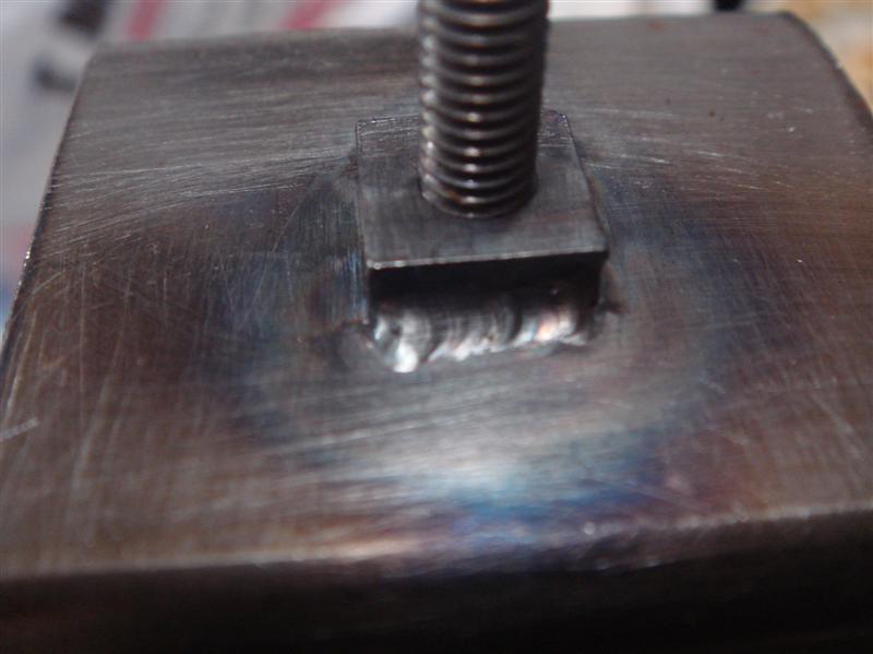

    Don't know if I'd call it micro welding, but here are some fillet welds about .060" wide to secure some #10-32 nuts in place, without rolling over the edges or causing distortion to the threads.

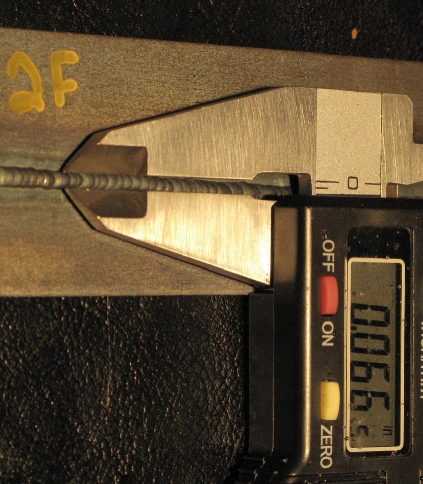

    Another one!Click image for larger version.
ID:	9652 about a 1/16th of an inch

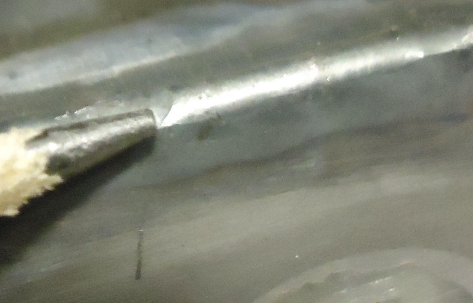

    Heres one of some 22 ga parts i was fabbing for my car, the lead pencil tip is .045 dia. 25 amps dc

    Best focus i could get with the camera that close

    Nice, Thats the kind of stuff that you just cant do with a mig.
