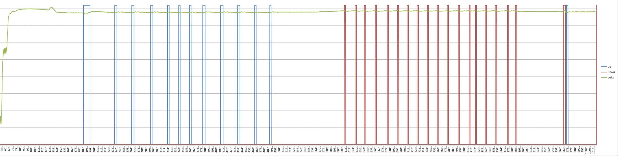

    I think the legend on the graph for torch up and torch down are reversed.
    The other software change included in this run was reducing the start of voltage control from 1200 ms after arc good to 800 ms after arc good.
    So, I've changed the torch up/down thresholds (=> 7 on, <= 3 off). I've changed the delay back to 1200 ms, and I hope to retry later today.
    Once I debug the obvious problems, I'll take a shot at videoing it.

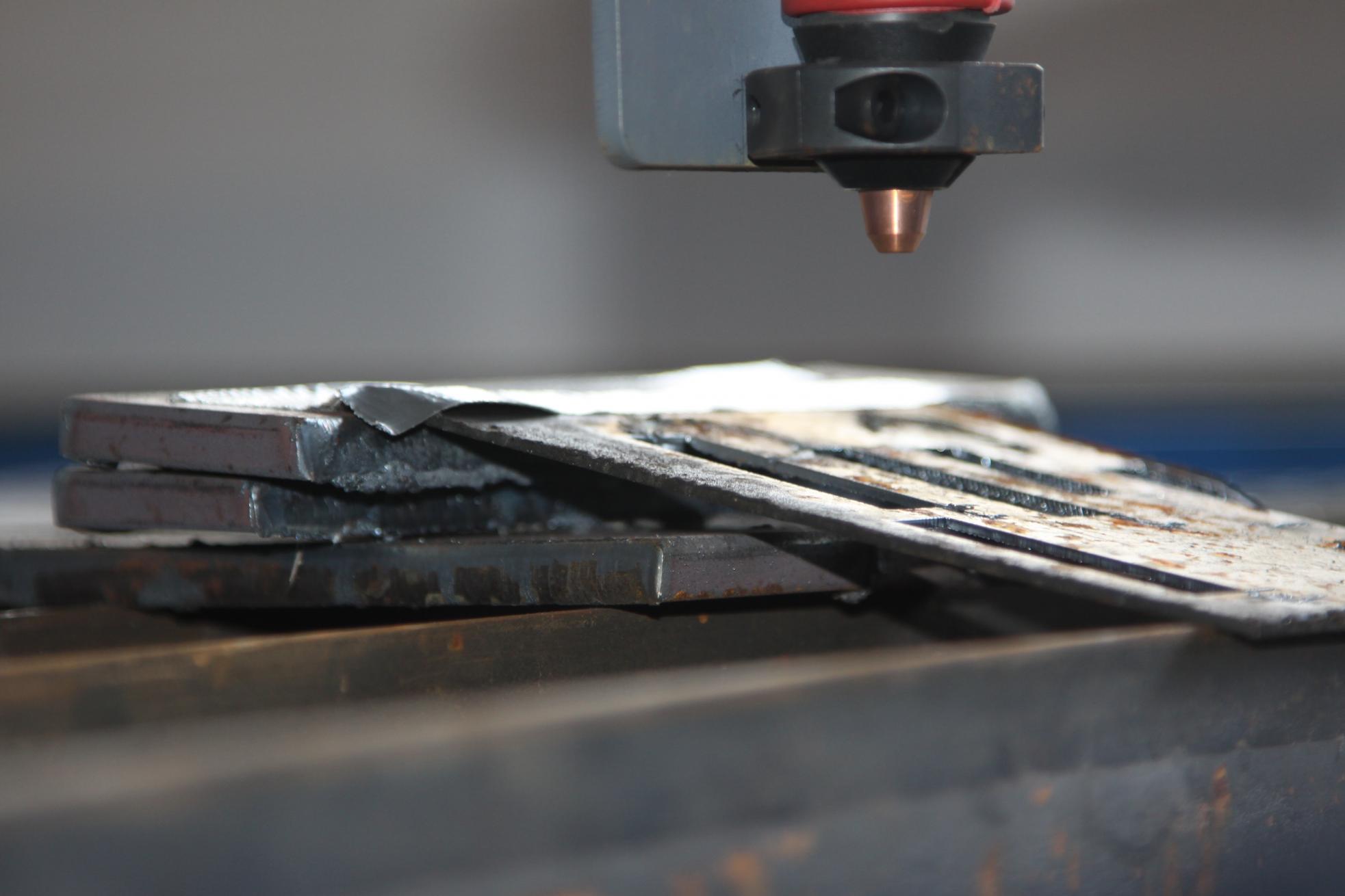

    Default Works Beautifully on a Simple Test Case
    Made all the changes I had mentioned earlier. I also found that I had the voltage hysteresis values backwards, so that was really screwing things up. General summary of setup is:
    • Turn on torch movement if >= 7 counts off (1 volt)
    • Turn off torch movement if <= 3 counts off (about 1/2 volt)
    • Currently using no software filtering on voltage
    • Delay 1200 ms. after arc good to start torch height control
    • Mach Z-axis speed set to 20 ipm
    • 16 ga @ 30 amps with SheetCam set to 60 ipm (but G-code using 40 ipm)
    The test setup is shown above. I cut a 2” long rectangle. The difference in height from one end of the rectangle to the other is 0.43 inches.

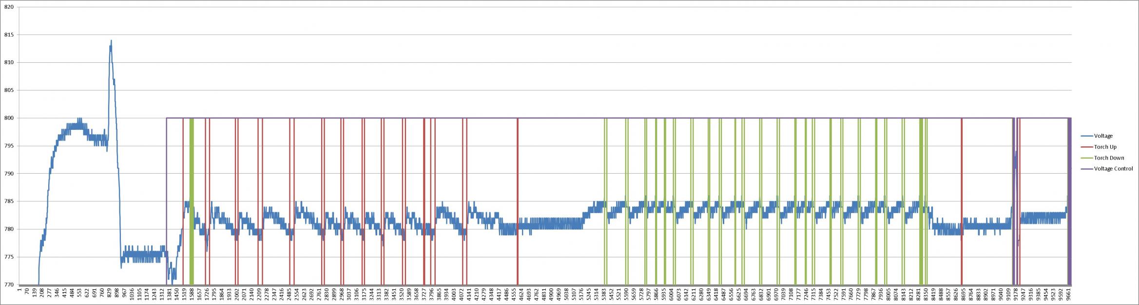

    The voltage capture with torch up/down signals is below:
    I guess I need to start thinking about other tests, and finally starting to use my table.

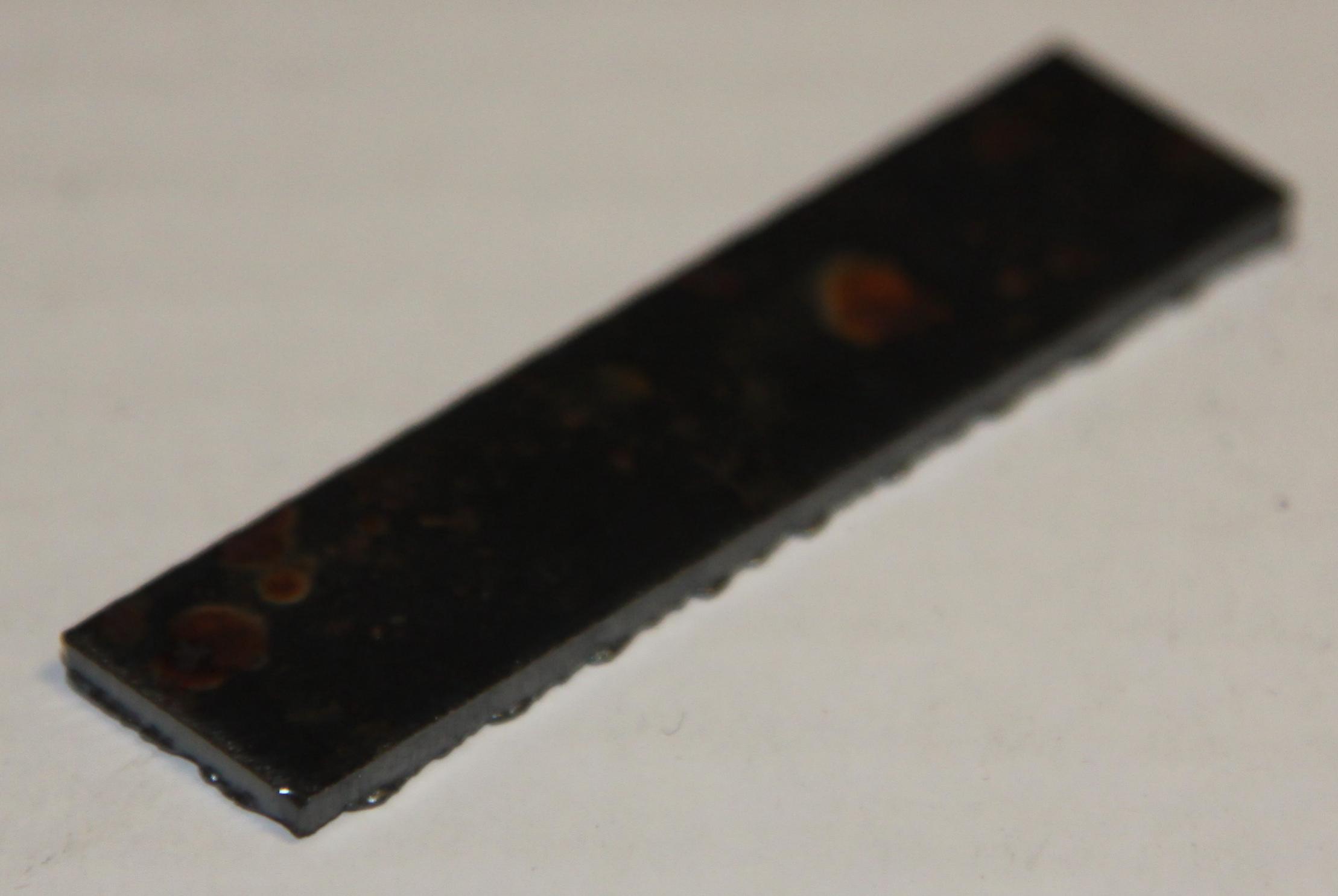

    Default Video of THC in Action
    I did a video with the same setup as the last voltage capture.
    I didn't realize that there was still a little "sawing" until I saw the video. I think that will be easy to fix by making the voltage control range a little tighter. I had made that change already based on the last voltage capture, I just hadn't loaded it into the THC yet.
    The cut piece is below. It's a little out of focus because I don't have a good close-up lens.
ID:	9303 Click image for larger version.
    In spite of the sawing, it still looks like a pretty decent cut. But I'm sure I can get it better.

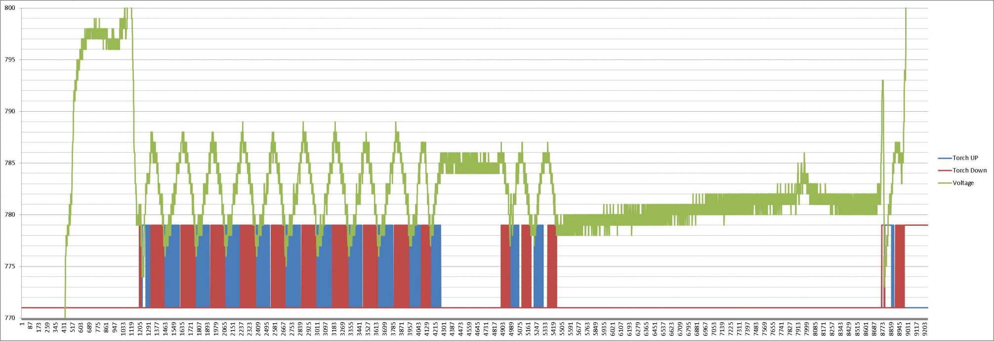

    Default Kerf Detection Appears to Work
    I've implemented an initial kerf detection that looks for rapidly changing voltage. While it can probably be impoved, it does work.
    This graph shows the kerf crossing. The voltage is in blue and the voltage control status is in red. It turned voltage control back on when the voltage dipped, but then turned it right back off. I"m sure this could be improved but its good enough for now.
    The full graph of the voltage, torch up signal, torch down signal and voltage control signal is below.
    What I have been referring to as a "sawing" motion is only going in one direction, so it's really just "stepping". I think the z-axis speed would need to slow down to "smooth" it out. I'm not sure if that's the right thing to do.
