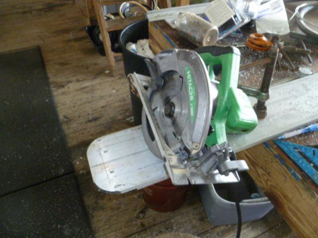

    I like the worm gear drive skill saw since turns slower works great for cutting aluminum with a carbide blade. Just wear goggle aluminum fly's every were lol

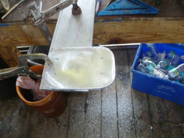

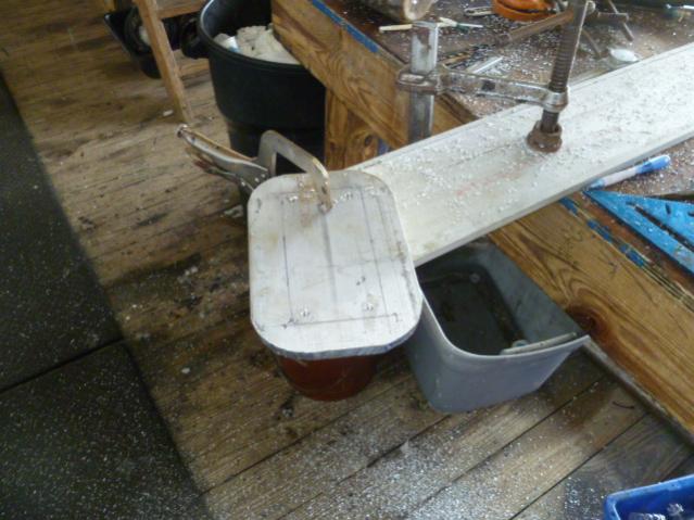

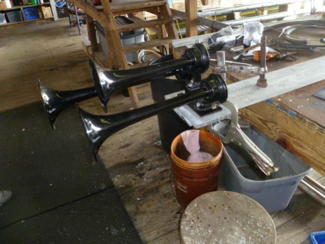

    hate to hijack a thread but it never hurts to let people know what they can do with a cheap saw. here's some pics of a doubler plate i made to mount a horn on an aluminum workboat. it is 1/2 by 6 AL/FB.
