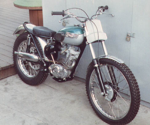

    lol i had a couple of triumph cub's they was neat Click image for larger version.
ID:	7286 also have had some BSA and Norton's

  11. #31
    I remember those ... Triumph Cub 200cc single four stroke ... what fun!!!
