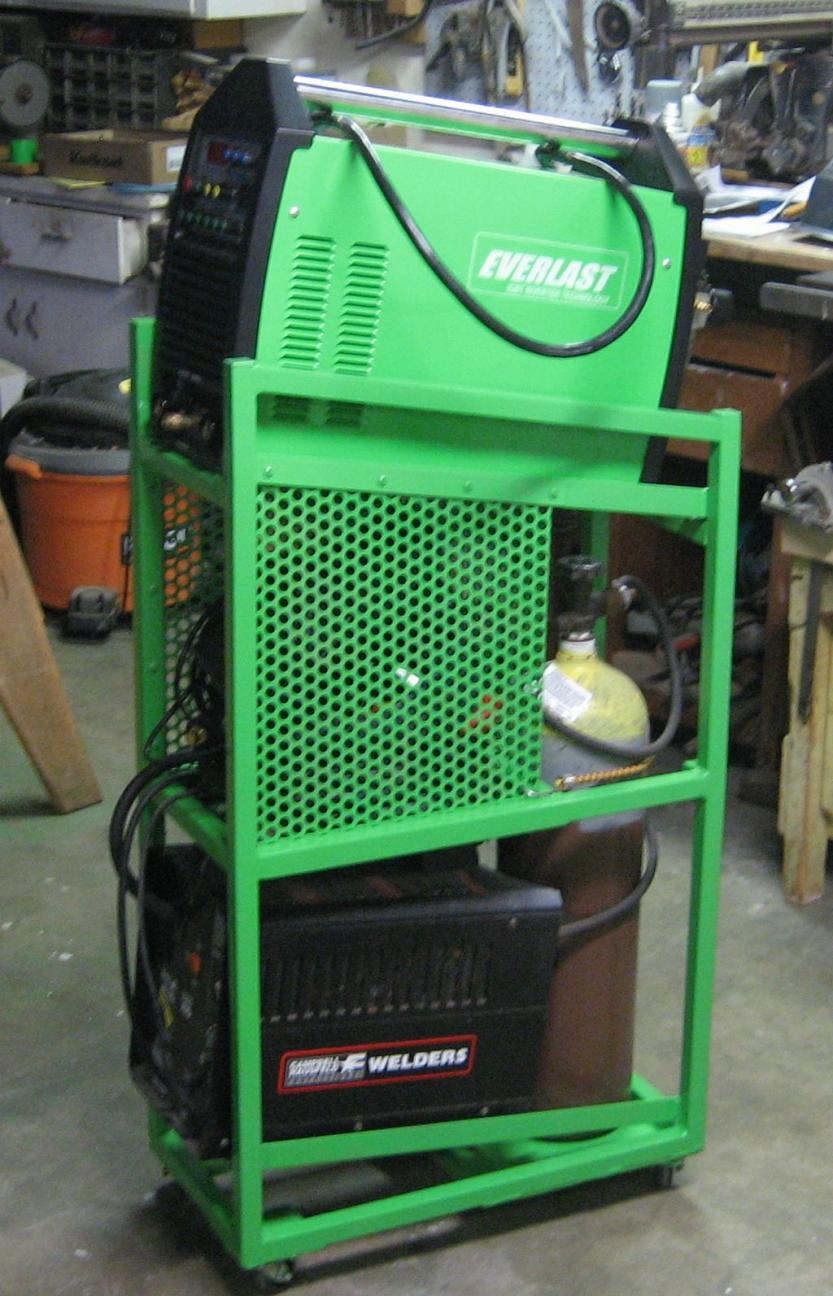

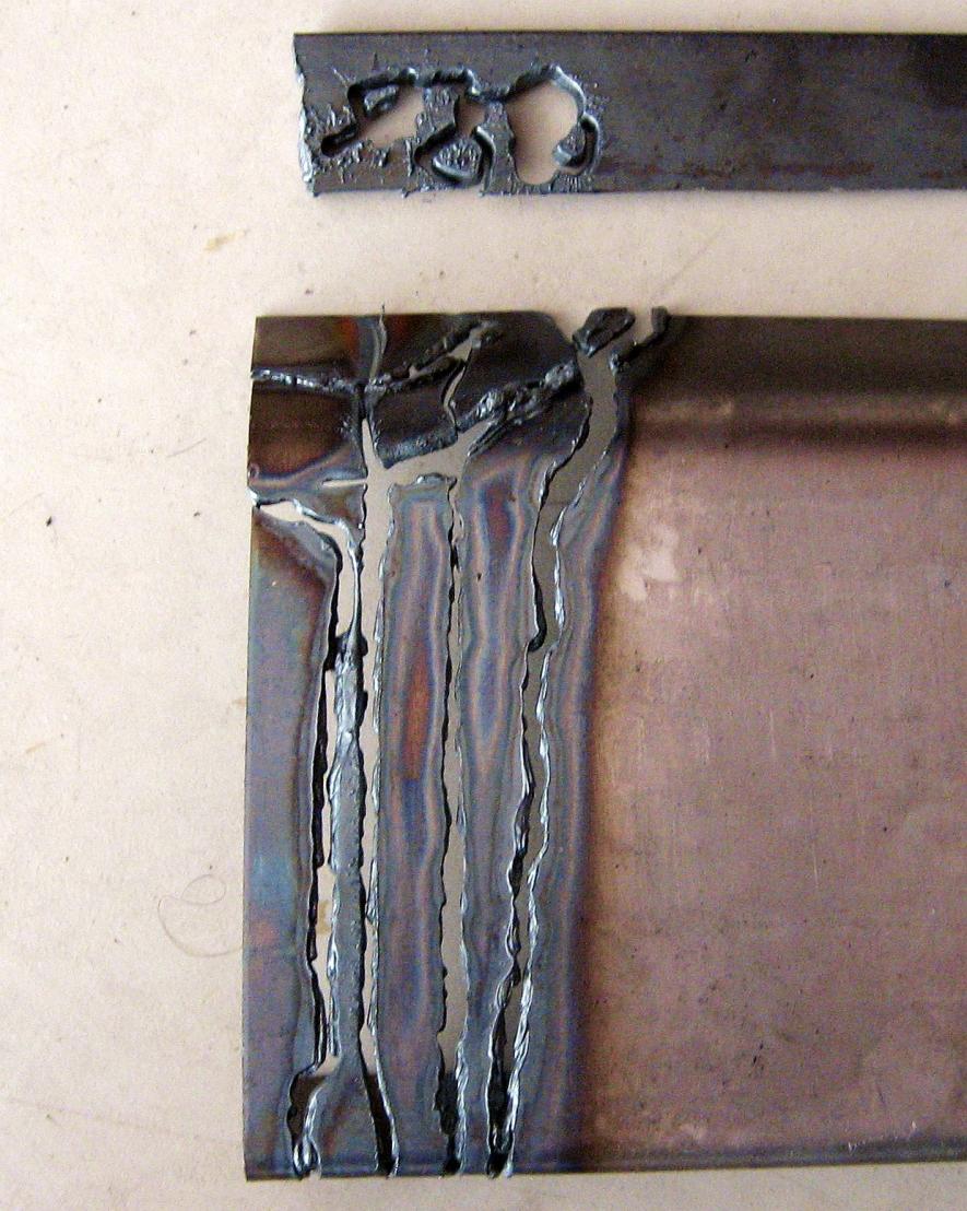

    Just got home from my day job. Reassembled everything, didn't change the settings at all, except for dialing the Amperage to max (65 indicated) and Success!
    Set the pressure to 60 and 80 but didn't notice any difference in the way it cut.
    Held the standoff on the edge of the work, angled the torch out away from the side and squeezed the trigger. A very small, bright white flame shot forth and went through the metal like it wasn't even there. No splashback, nothing like before.
    Don't know what changed, but that confirms that the cutter really does work. Now I need to make some guides so I can cut against a straight edge.
    Thanks for everyone's input. Sure wish I could say exactly what the cause of my problems was. Could it be the new welding cart fixed it?

    It looks like your running too hot. You want to cut the metal and not melt it away. You probably could cut that material around 30 amps. I think 50psi is what I run.

    Thanks, I think you're right. Went through a piece of 3/8" angle at the same setting and realized I probably could have dialed it back a lot. Having no frame of reference yet, I need to experiment and see what gives the best cut.

    Something simple, anyway. I was afraid it was the HF circuit not transferring the pilot to the work. That doesn't seem to be the case. However, I tried dialing back the power to see how low I could go. And lighting the arc just off the edge of the work, I can' go below 50A or the arc blows out just as it did yesterday. But when I squeeze the trigger with the tip over metal, even just the bare edge of the work, with the amperage set to 50, 40 and 30A the arc lights and I can cut. But below 30A and it just "pops" and the arc blows out. I'm wondering if the "points" gap inside might be set wrong. I understand about 0.030" is about right for this machine.
    So I think part of my problem earlier was that I didn't have the amperage dialed up high enough to light the arc reliably.
    And sure 'nuff, dialing the power back resulted in a much cleaner cut, less slag, etc.
