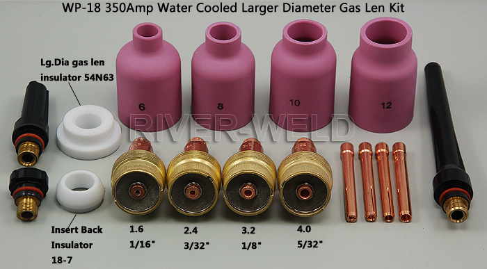

    2% Lanthanated is what i use all the time. I order some better welding tig gas lens today Attachment 6972
    Hey Rod, where did you get your gas lenses? Or, where is a good place to pick up some good value gas lenses?
    Maybe river-weld.com ?
    Email: everlast@us-it.net
  8. #48
    I saw the exact same package on E-bay ... don't rmrmber the vender but if you search tig consuables or tig torches it whould pull it up.

    I think he is 3river. But Ray and I notices he changes it sometimes. River-weld.com and you can contact him. Forgot his name.

    http://www.ebay.com/itm/170792774988...84.m1439.l2649 got from river weld great prices but takes a week or so to get , getting them this Tuesday
  11. #51
    http://www.weldingcity.com/ $1.79 for wp-9 size and $2.79 for 17/18 size. I've made 3 orders there so far with no problems.
    I have been hobby TIG'n for at least 6 yrs, but just bought my first gas lens when I purchased the 250EX in March. I can not go without a gas lens now. I just recieved a large diameter gan lens...these things are massive.
    I was using zirconated for AC but I am trying those rare earth and have Lanthanated I have yet to try. I am digging my 250EX over the old Synchrowave 180 at this point. Love the 20WP torch, smaller and cooler.

    Thanks guys. You folks using a lens because of the better coverage in general, coverage in cases where there might be a bit of a draft or to save gas (if that is possible)?
  15. #55
    I don't think it will help much with a breeze, but I hear you can increase the tungsten stick out. Then the larger cup tends to offset that some.

    OK, Rod's pictures is river-weld.com (safe and good to buy from), good deals on EBAY too. Been mentioned for a long time here.
    I bought my last WP-20 lenses from weldingcity.com (and his MIG wire is safe too), it has also been said they are safe and good by many for a long time.. On the cups, make sure you tell him the series torch you have.

    "OK, Rod's pictures is river-weld.com (safe and good to buy from), good deals on EBAY too. Been mentioned for a long time here."
    I'll have to remember that because I do want to try some gas lenses ... I've been using a small cup and no lense on my DC unit and it's really a pain to see what I'm doing with the electrode stuck so far back ... it will be nice be able to push it out a little further.
