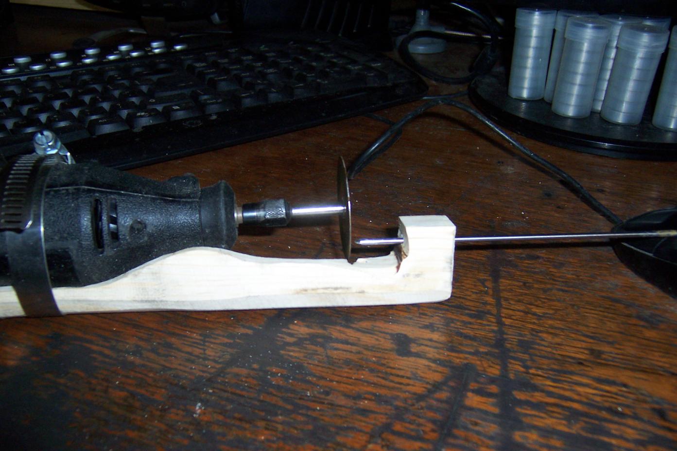

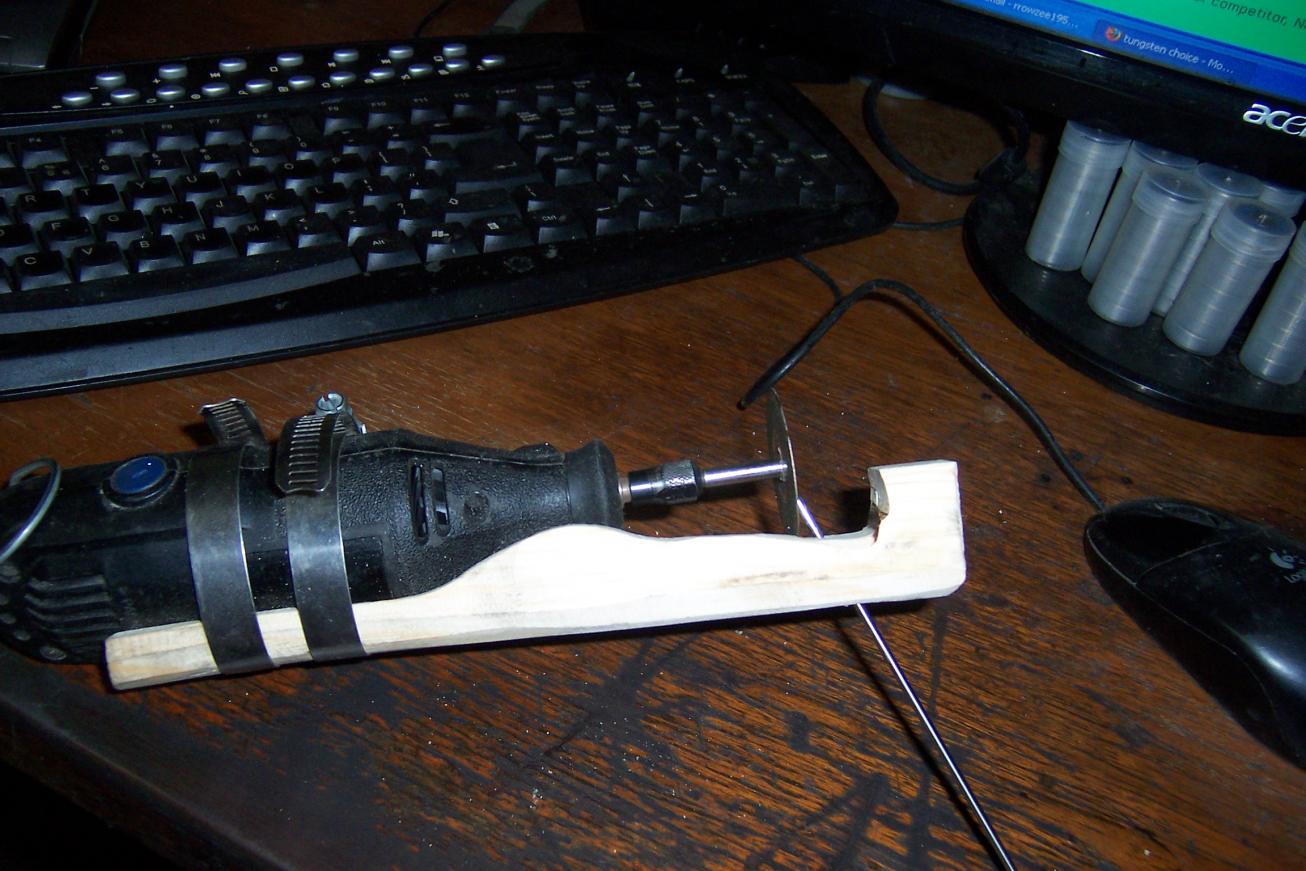

    Red neck tungstenClick image for larger version.

ID:	7002 grinder works good lol
    Red neck tungsten grinder works good lol
    looks good from here. seven inch grinding disc works well. so does breaking off the end by whacking it with a hammer on the edge of a steel table. then balling it.

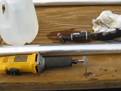

    die grinder with wheel worked well.
    bosch belt sander with trigger lock even better. sat perfectly flat when it was upside down. used that till i bought tungsten grinder.
    tungsten grinding. it doesn't have to be, in most cases, so complicated. like one guy wrote; i used a rock. lol
ID:	7003   Click image for larger version.
    Jerry's hardware didn't have what I want ...but ... red neck tungsten grinder ... ah ha ... I have a dremmel tool on a flex handle with speed control ... PERFECT! Thanks Rod ...you gave me a gr8 idea! I might change to a different tip but the idea is sound. Safe and effective ... I love it.

    yes the little diamond disk and arbor are real cheap

    Problem with them, everytime they go on sale I buy a pack. I have at least 10 "5 packs" now and I give them away all the time to people. They work great, last a fair time and will not fly apart on you either (metal disc). Thanks for sharing the red-neck tungsten grinder Rod (and if it gets contaminated, cheap to change to a new disk).
