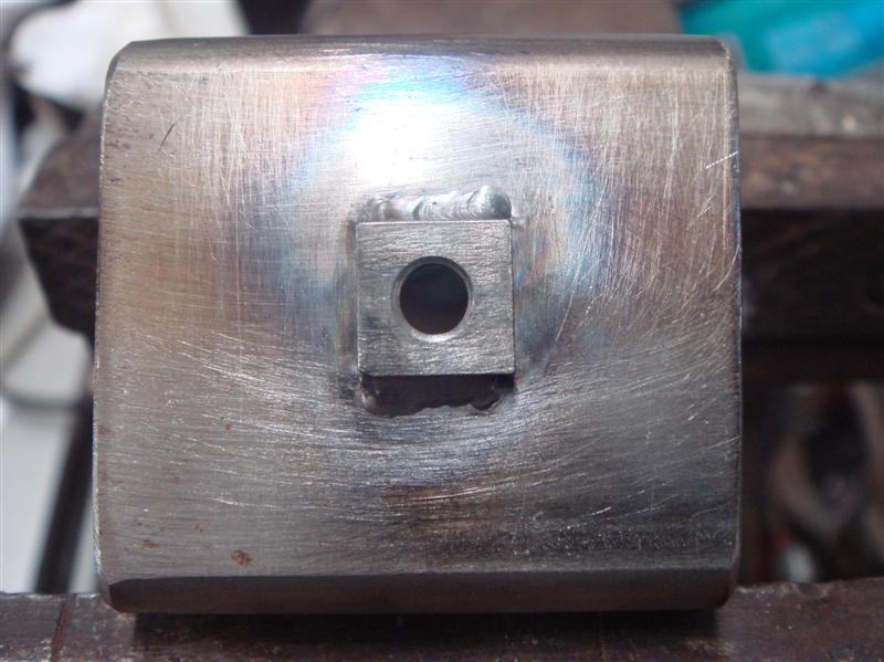

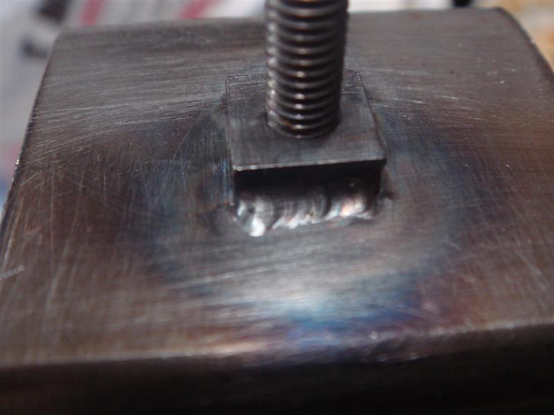

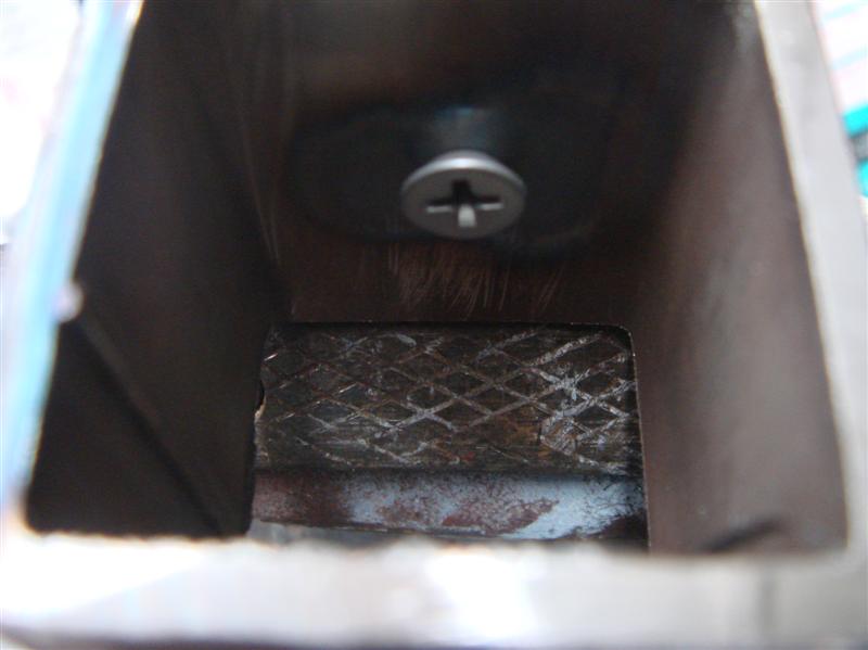

    If I have access I like to use a countersunk screw to hold things, because it will self align to the center of the hole. Otherwise you sometimes have the bolt drag a side and it will be stiff. I couldn't find a 1/4-20 square nut handy, but here is a #10-32 as an example. Two sides are probably stronger than the screw, but if you want, you could do all four. Just let it cool a little in between. Because of thermal expansion and cooling, after this was welded and had cooled, I could spin the screw out with my fingers.
