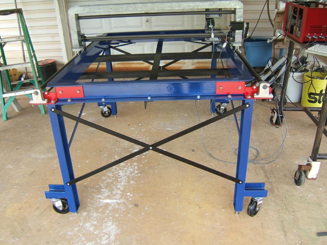

    Hi All
    Here is a cnc table I built with plasma cutting option. I am using my PM256 Multi unit for the plasma power.
    This table was built with no plans using things I seen others do for their tables. I ran grounds from the computer/control cabinet, table base, and PM 256, wiring using shielded cables and farrite cores. This seems to have protected against the EMI from the PM256's HF start. Still need to fine tune it but it cuts very well.

    That is so nice looking so how much total in parts and materials cost to build it. like the chain drive system . plus look not to heavy so easy to roll around to were you want it
    Really nice work.... I like your videos, hope we get to see more of this table in action.
    forgot what arc divider board did you use and controller for your table
    Look at you getting fancy with the cross drive! That's the way I wish I would have gone. Saves money and possible trouble. Are you using THC or touch and go? You have a very nice cnc table, I hope mine looks half as nice.

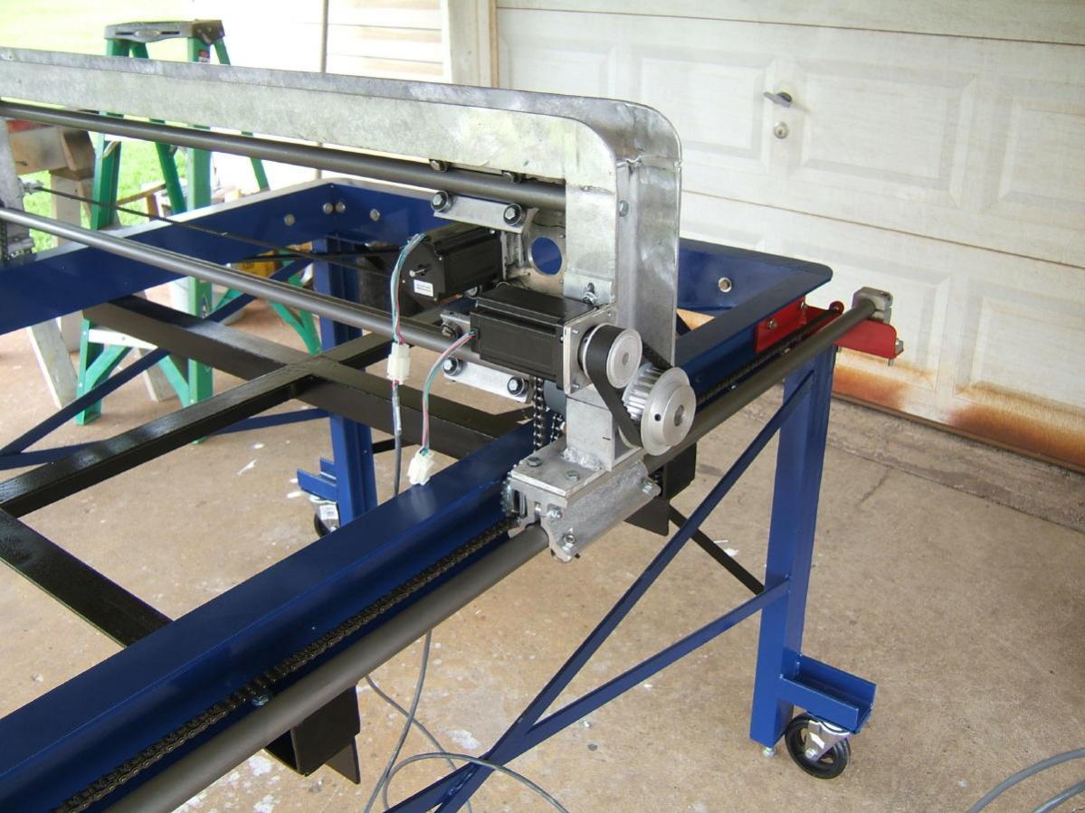

    I don’t have a THC I am not planning on doing any big jobs with it. I a using a pilot arc so it is not a touch start it touches metal to get the distance. The software zeros out the Z distance when it touches the top of the metal and then lifts about .750”. And drops back to .035” fires the torch and delays to burn through and then starts the movement for the cutting.
    I would say I have less then a $1000 in it $550 for the electronics and software I have a computer to use. The table sides and carriage are 4” aluminum channel I scrounged along with the steel legs. The chain drive is cheaper then other types I bought the stuff from Surplus Center (chain, idlers, and sprockets) #35 size chain. I cast the bearing sliders for the X & Y rails from scrape aluminum.

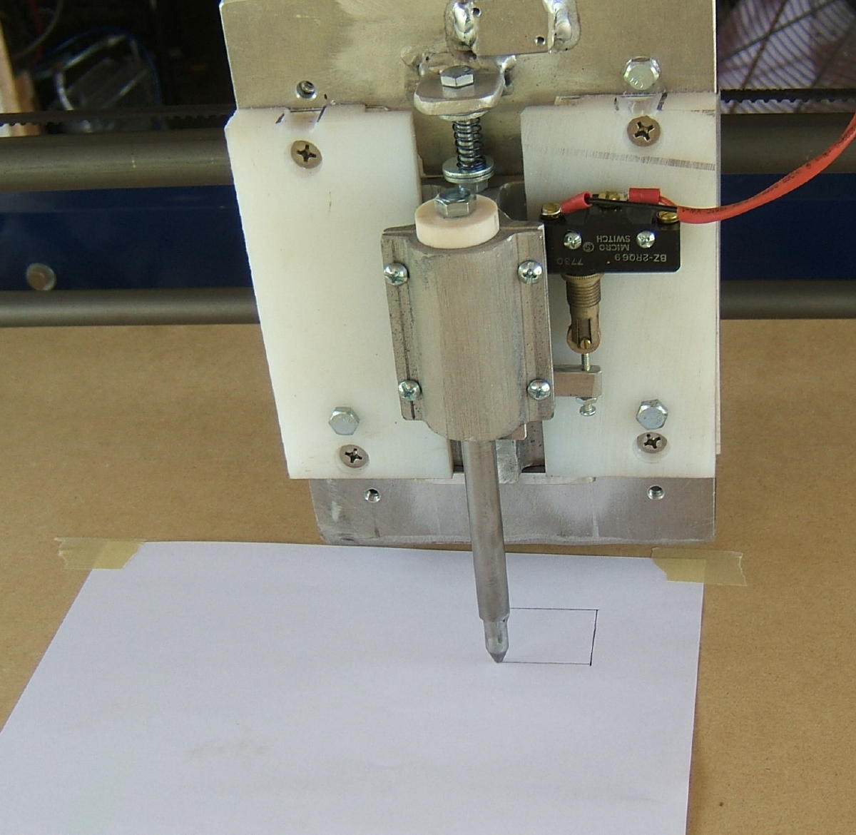

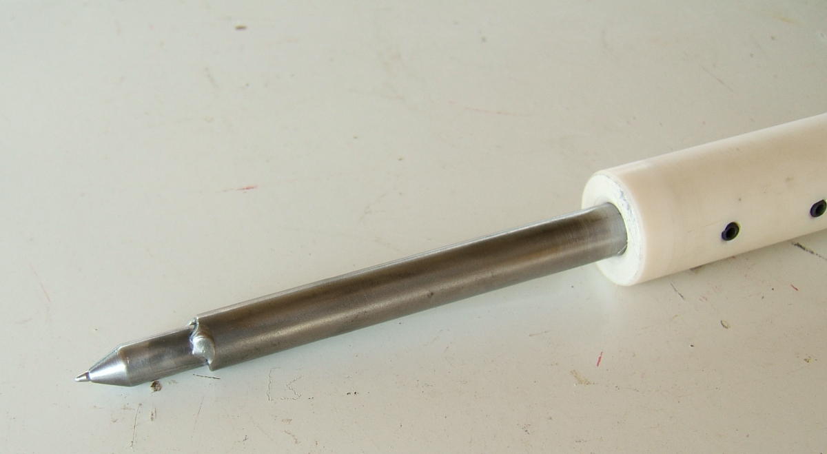

    I am using Mach 3 to run the table I have turbo cad but don’t know how to use it yet. I have heard good things about bobcad and sheetcam the software can get expensive. I’m out on a limb here so I need to learn these things by myself. Here is a pen I made to use on the table to check it operations before cutting anything. It fits the floating head for the plasma torch.

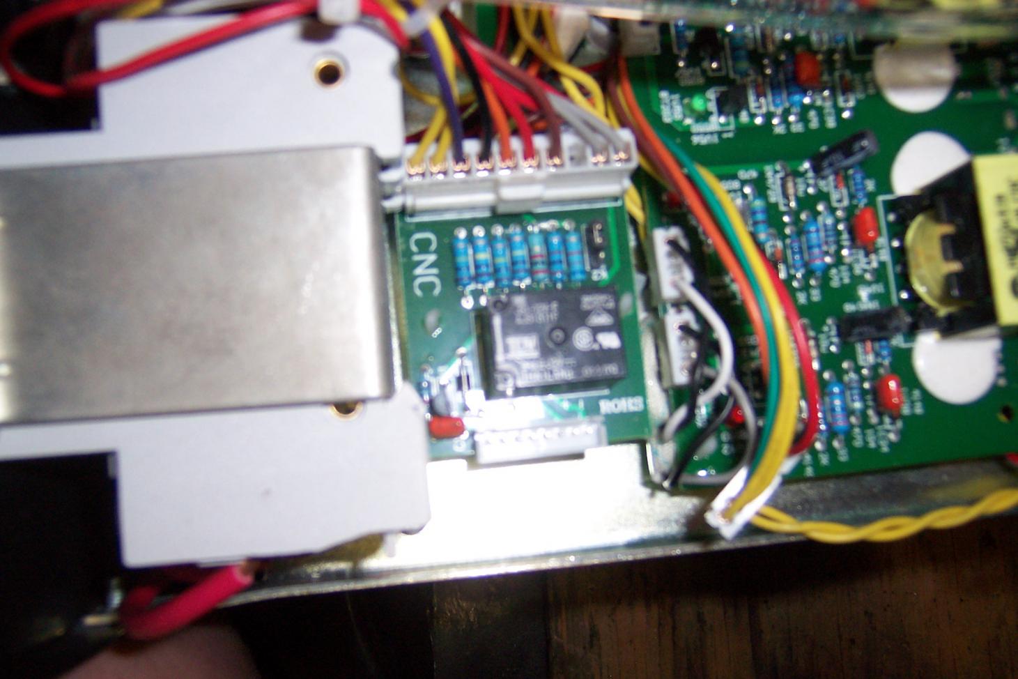

    pulled open my plasma cutter sorta goofy little ark dividerClick image for larger version.
ID:	6625 board , sure be nice to have more information on this . looked all over the internet and could not find any information on it . think i will toss this one i found a better one on the internet
    I did not use proximity switches I started out using a magnetic electronics switch but switched to normal micro switches. Hooking up the limit/home switches if quite easy with Mach 3 you go into a menu and tell it which switch you are working with (X home) and activate the switch and Mach see it and logs it for that use. Setting up the software is easy as soon as you get into their mind set or method for doing things.
    Proximity switches are expensive unless you know of a cheap place to buy them.

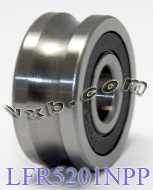

    these are cool bearing would make it simple to do rail 2 bearing 2 on top and 2 on bottom of round bar bottom rollers could be spring loaded to keep tight Click image for larger version.

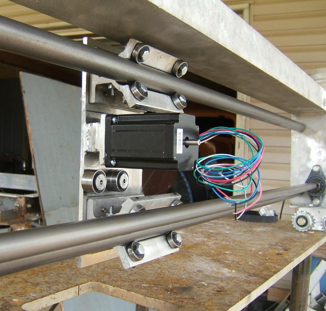

    The usable tooling area is 35” X 45” the footprint of the table is larger.
    All the shafts are cold rolled steel the rails for the guides are 1” and the drive shaft is ¾”.
    The linear bearing holders for “X” & “Y” are cast aluminum that I made and machined them.
    The “X” are 6” long and the “Y” are 4-1/2” long they were cast a separate parts and them machined.
    The torch I use is a Panasonic P=80 with 1.1MM tips it is a pilot arc start. The metal in the video is factory painted metal and the pilot arc when right through it fine. I have heard of buys using blow back torches but do not know how they work.
    Neat looking bearings like all the DIY projects everybody does it a little different. I used skateboard bearing as they were cheap and easy to get.
