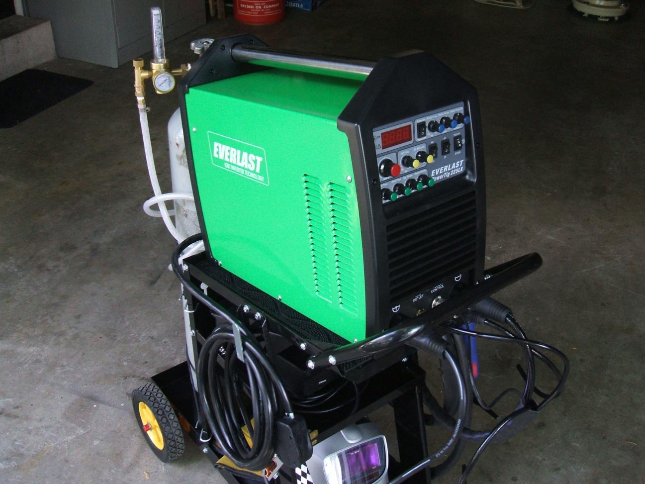

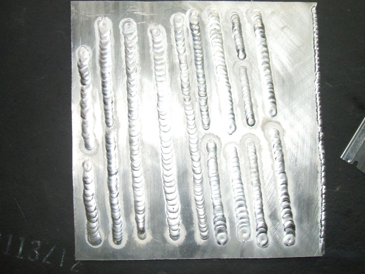

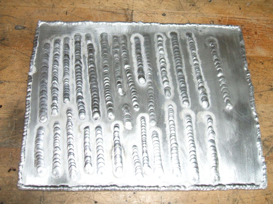

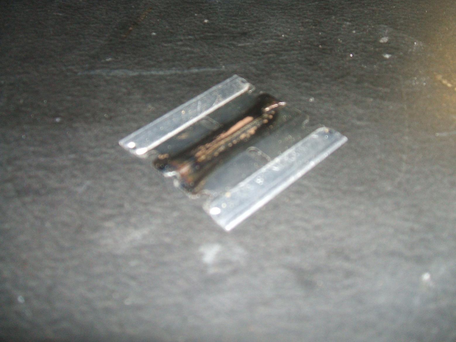

    Hello from Lancaster, PA. Just purchased my first Everlast product, the Everlast PowerTig 225LX, and all I can say is what an excellent machine. Would like to say a special thank you to Alex for the great customer service. I was apprehensive about the machine having a pulse frequency of .5 - 25 pps. but after having a nice talk with Alex and his detailed explanation of pulse frequency and this machine, I felt this was the welder for my needs. I am posting some photos and you can see I was welding beads (using pulse function) right on the edge of .063 aluminum quite easily... now remember, these are my very first beads with this machine and I feel with more seat time, I'm going to get this welder really dialed in. I wanted to show you something right out of the box. Other practice beads were run with, and without pulse. All welding was done with parameters set on machine. Foot pedal was not used.

    welds look good , the more you weld with the welder welding stuff you will get better , took me awhile to get use to a more complex tig but it is nice . I have the everlast 250ex

    Welcome to the Everlast forum. Those are nice welds.

    Thank you. I think patience is the key... just take your time and find that steady rhythm. I use 1-2 seconds of pre-flow and wait for the aluminum to puddle. Dip and then move about an 1/8" and repeat. Post-flow I have set to 2 seconds. The beads on the edge... I played around with pulse frequency. Some were done at 1 pulse per second while others I used the max 25 pps. I really wanted to exploit the extremes of this machine to see the effects. I just took the machine out of the box, wired my plug, attached the flow meter, and then went to town. Let me tell you guys, if I can do it, you can too. I'm headed to the garage to get some more seat time... see you later.

    Nice job and thanks for sharing! Do you mind me asking which welds you used the 1-2pps pulse and the 25pps? Also, did the 25pps frequency ever give you eye strain?
    This post is from April, hope Johnnyfive is still online to respond. The real slow speeds should not bother your eyes if that is what you are asking, and will give you a timing (metronome) for dipping the filler rod.
    Email: everlast@us-it.net
    Johnnyfive hasn't posted in over 6 months so there is a good chance he's not going to see your question.....
    I use 1-2 pps for timing to get the stacked dimes look and keep the heat down on corner work. 25pps is the same with keeping the heat down some on corner work. Never had any eye strain from it. Does watching a movie at a theater give you eye strain (24fps) or tv (30fps)?
