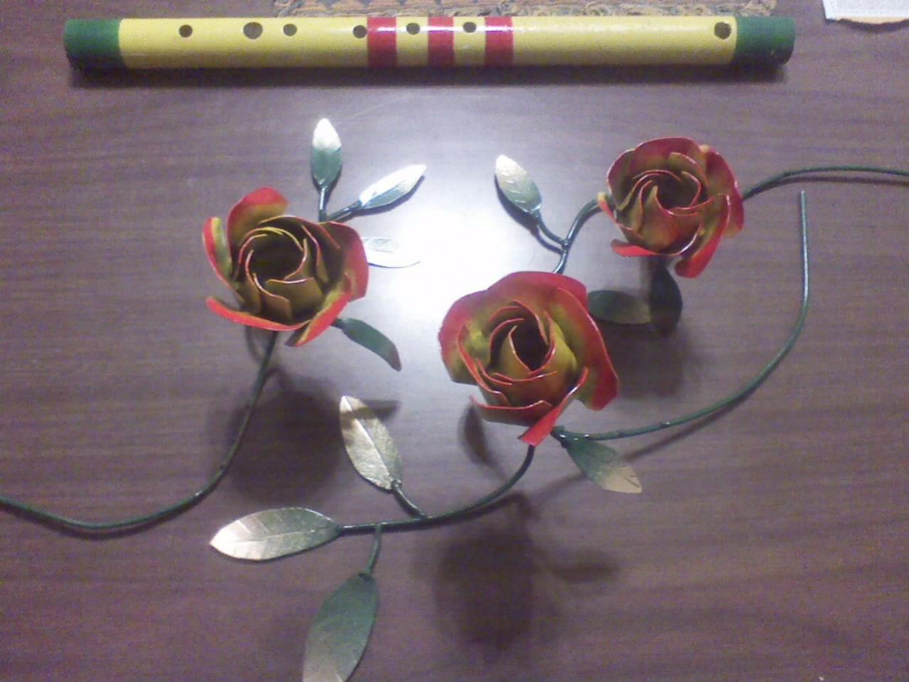

Name:	roses 9-April-11.jpg
ID:	6526 Here are a few roses I did in the Vietnam colors behind it is a flute I made with the same colors.

    Winky you should do a video on do a rose it would be cool to see how you do it really like the black roses with the gold
    Rod ... I wish I could take credit for the black one with gold ... it was done by JP2CODE I did all the others ... (go to the gallery to see them) they are pretty easy. I take 22 gage sheet metal cut two circles then slit them into the center about 3/4 of the way in ... lay the circles on top of each other drill a hole ... peen a piece of 1/8" round stock insert then weld the top and bottom ... bend the petals up and shape them ... cut out the leaves ... weld it all together ... bend to shape then paint ... clear coat and if I add gold high lights I add that on top of the clear coat so it will reflect the light. I just got a plasma unit so now I'm going to start cutting out the parts with it to give them that rough look ... Maybe I will make a video of that sometime.
