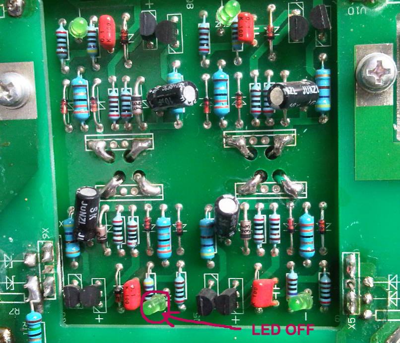

    I've tried again to readjustment the point gap in accordance the instructions.
    I also clean the points with contact cleaner. But my tig still does not work, still weak spark.
    And when I press the trigger I saw the green LED on bottom left side at the IGBT board is off. The three other LED is on.
    is it any relation with the LED indicator?
    So what the problem with my Tig.

    You have cold solder joints located on the bottom of your picture - X5 and X6 areas. While they "may" not be your problem, they still should be fixed...
