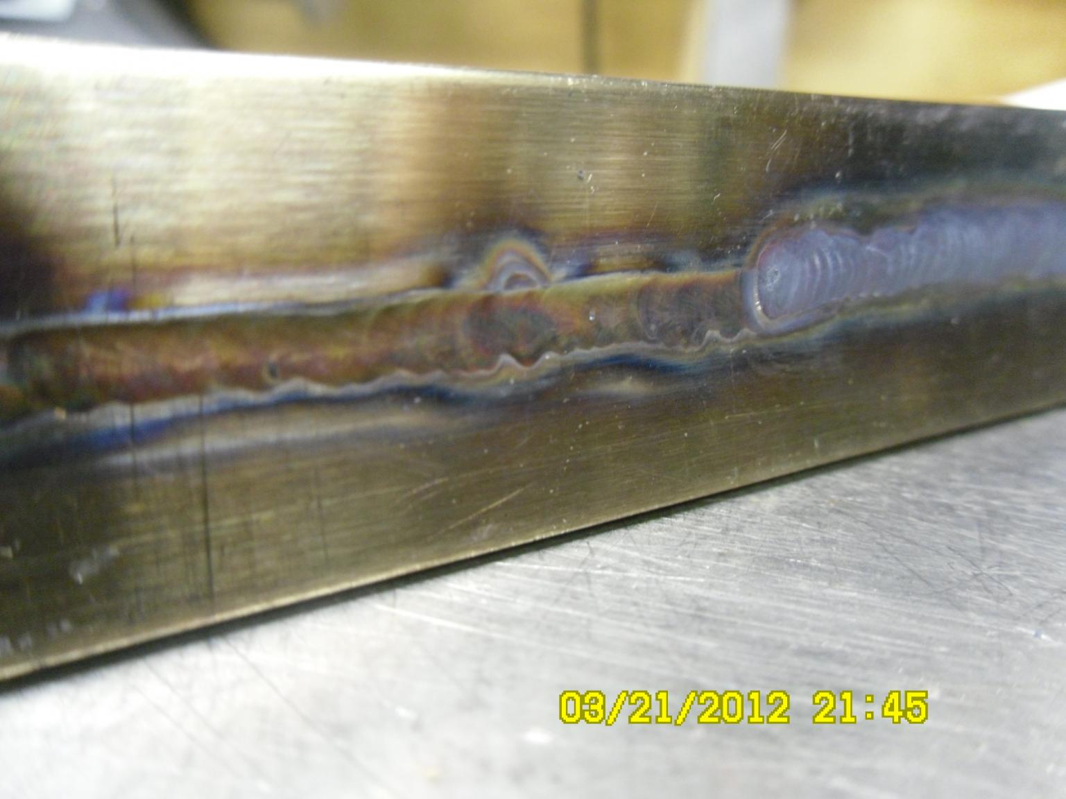

    Here's what I got with the machine on 120v. oh and all i had was 1/4 steel. amps at 45. air at 65psi.
    the welding was all pedal. with 3/32 lant. pure argon. 5 cup.

    120v w/filler
    120v fused
Name:	120v fused.jpg
    The machine didn't hiccup at all. hope this helps.

    sydneysdad, thank you very much. Did you drag cut or hold the cut about 1/16" -> 1/8" above the metal? Your PU205P definitely cuts better than mine on 120V. Thanks again,
    Ken
    I dragged it on the wire guard thingy thing? what ever its called.. lol which is about 1/8 from the surface.
