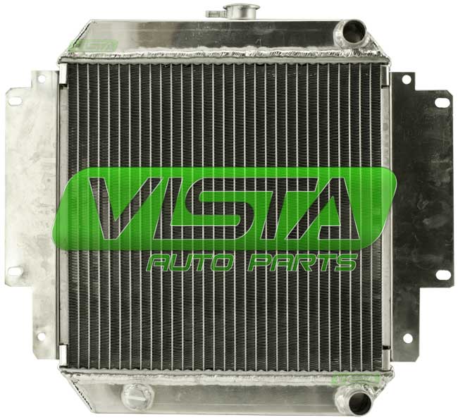

ID:	6319you can pick up good heavy duty trans coolers at wrecking yards of cars with tow packages or trucks i picked one up for my cooler looked like new for 15 bucks . was thinking since i specialize in Suzuki samurai repair should have used one of my trick samurai radiator,s i use since there all aluminum . they are only 125 bucks - also a car a/c evaporator would be good to use since are very high in removing heat and made of aluminum
