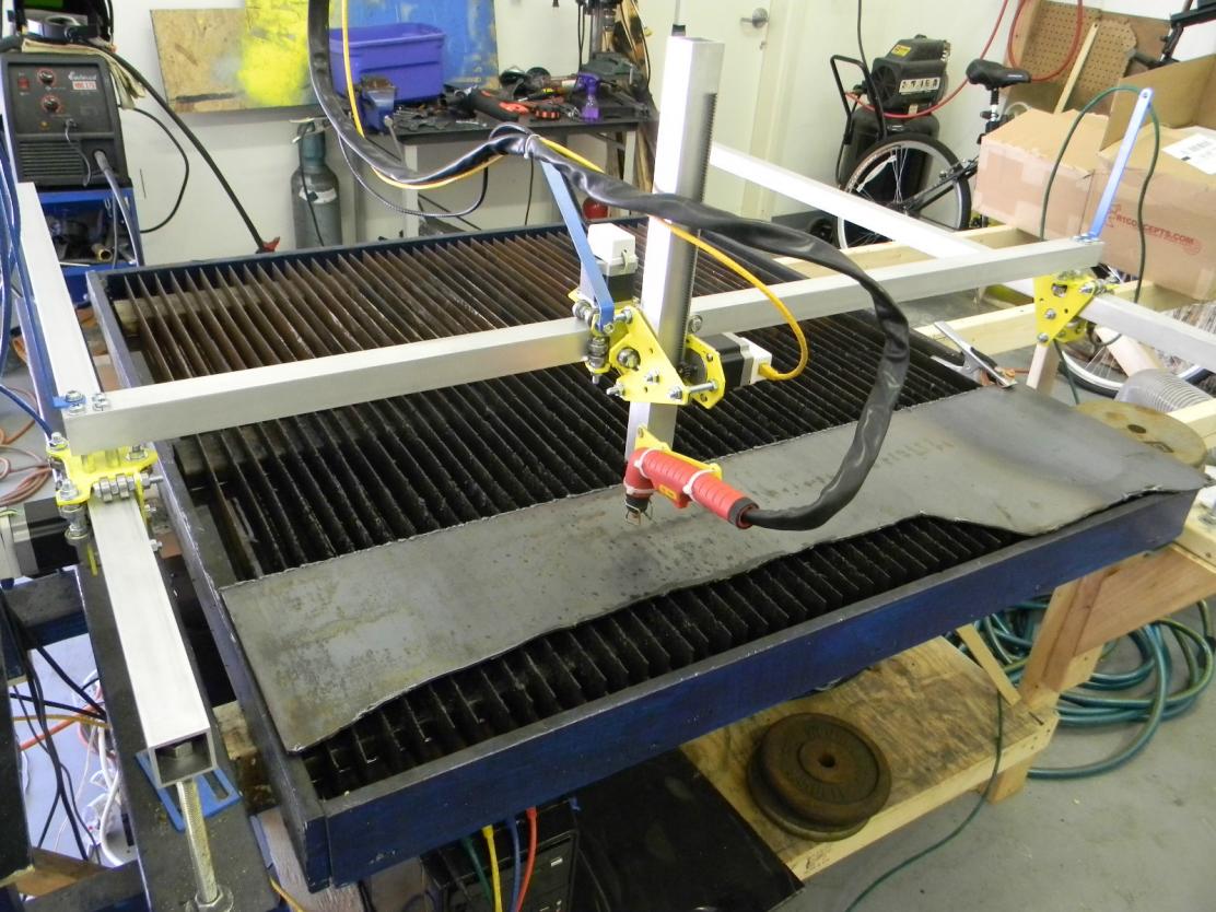

ID:	6387 its under 2000 and you get the computer and every thing just have to build the base i like the tracks facing down so you don't get spatter in the tracks and dirt this is the 4x4 but a couple of hundred more its a 4x8 like this to since all the cables are shielded computer lan cords with nice connections

  17. #57
    is it bowed down or up
  18. #58
    this is the one i going to buy almost there with the funds Click image for larger version.
    Who sells that kit? It looks a little lightweight, but probably fine for a plasma.
  19. #59
    http://shop.gearheadcnc.com/ not my fault they push longevity welders lol
  20. #60
    i would rather have aluminum than steel since there's no real weight
