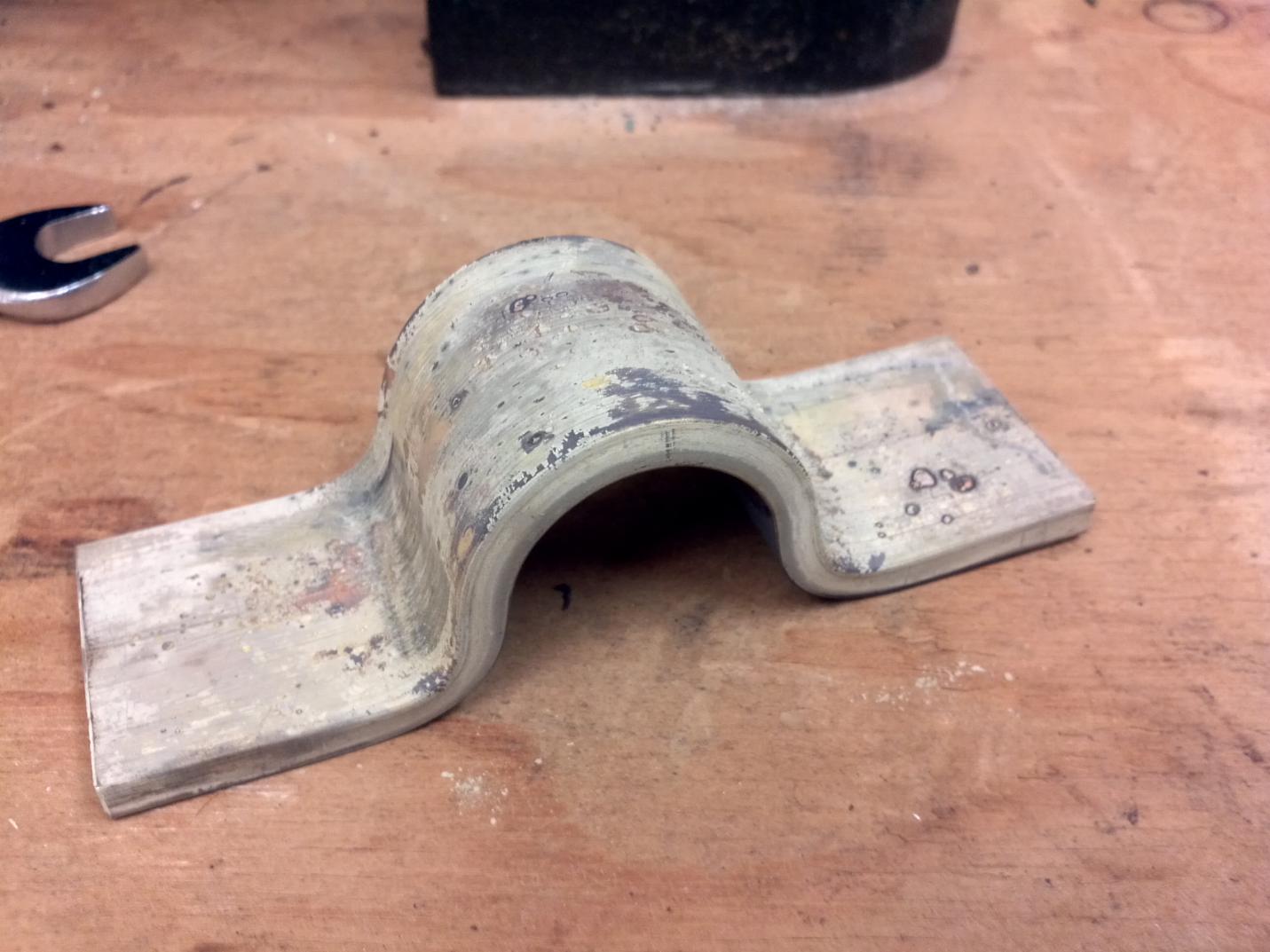

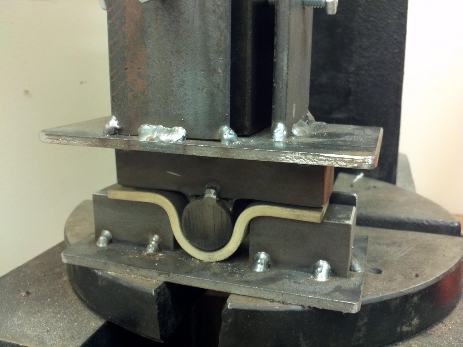

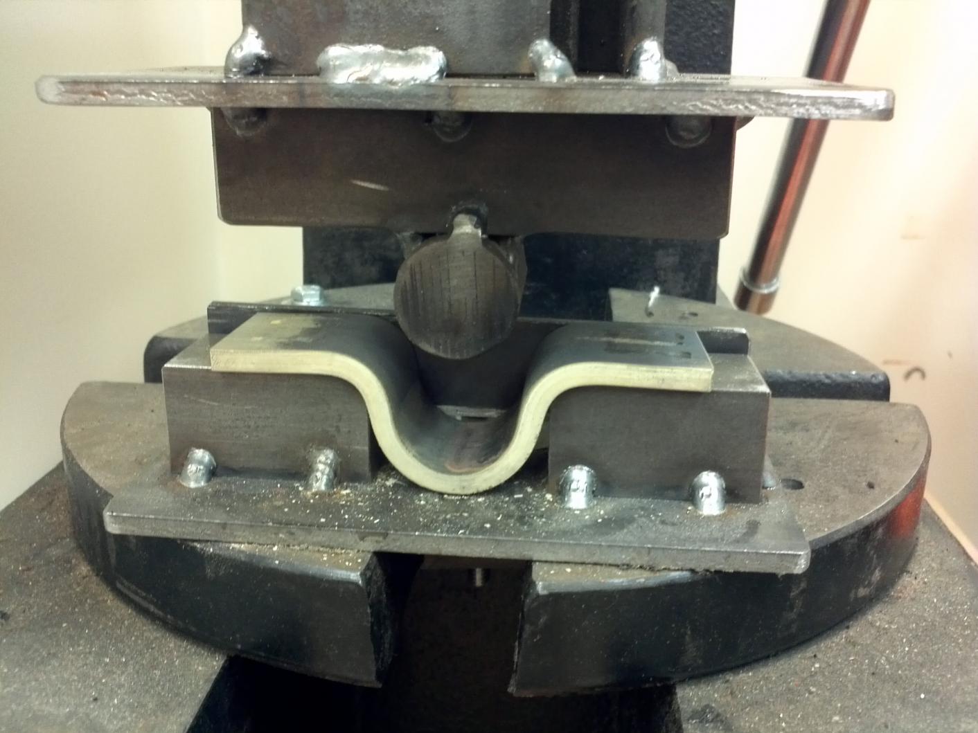

The brass is then heated till glowing a dark red (best viewed in low light), the then transfered to the jig, and pressed into form with one pull of the handle. The transfer does not have to be super fast, as forming the brass while too hot may cause it to crack. Some minor tweaking on the anvil is necessary afterward.
