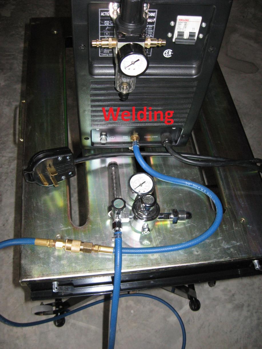

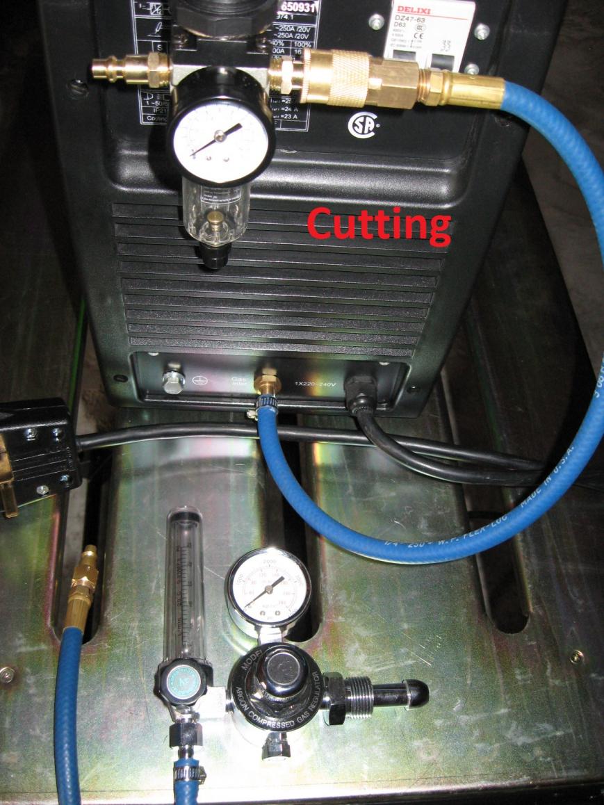

    If you're feeding the pressure regulator on the welder with 80psi you should be able to maintain 60psi at the torch. You could bump the line pressure to 85psi if need be.
    I don't have any problems with the pp256 or the pp60 running QCs from a 100' hose reel.
Name:	IMG_1155 - Copy.jpg
ID:	4863Click image for larger version.
Name:	IMG_1156 - Copy.jpg

    I use two shutoff valves and a tee. I think it is a better idea than quick connects.

    Quick disconnects are available with a larger inside diameter Most automotive styles are set up for 3/8" hose. The inside diameter is only about a 1/4" on the male fitting. Get the ones set up for 1/2" hose, then use common pipe bushing adapters to get it to the size hose that you have.
  18. Default
    There is absolutely no issues using a Quick connect in regards to having moisture enter the lines. After all we are talking a Multi -Process unit that uses compressed air . As the plasma and tig function share the same lines / solenoid you are introducing a lot higher percentage of moisture in the system even with a Dryer inline than simply connecting and disconnecting a Quick release .
    Zoama's set up is nice clean and simple
    I like it.

    I went to home depot today and picked up some quick disconnects with a larger inside diameter. They are Husky sku 412 721. The package comes with a couple of males and a female, along with some pipe fittings for about $10.
    I`ve got the same set up as Zoama. no problem so far and the nice part is if i have to move the machine for cutting to another building or location i don`t have to lug around the argon regulator, with the yap style you would have to.
