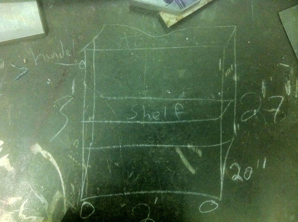

    Well got my aluminum today, turns out its only 1/8". To bad i started cutting it already. Basic specs are 2'L x20"W x3'H. Its only 2'9" in the back to have a slight angle. Ill have two pieces down the center on the top to support the plasma and tig. The middle will have a shelf to hold project 1, the water cooler. Ill put some abs tubing on the side to hold rod, and also have a small platform to hold the gas. The first pic is the highly accurate blueprint, and then just some cuts. I didnt get all the pieces cut tonight, maybe tommorrow.
    EDIT : did this on iphone, cant flip the pic sorry. Maybe if i find time tommorrow ill fix it.

    Hey jerky - I flipped your drawing the right way.

    Looks good so far.. Are you going to add on to it to hold a bottle or two for the welder(s) that will sit on it?
    Everlast 255EXT - On Order
    It looks top heavy to me. Is that bottom shelf area to put a few cinderblocks on to help prevent tipping?

    Well, dont ever use aluminium. My middle shelf wasent big enough for the plasma, so i took the handle off and jammed it it in there. I dont have casters yet so its probably going to wtay inthe corner for awhile.
