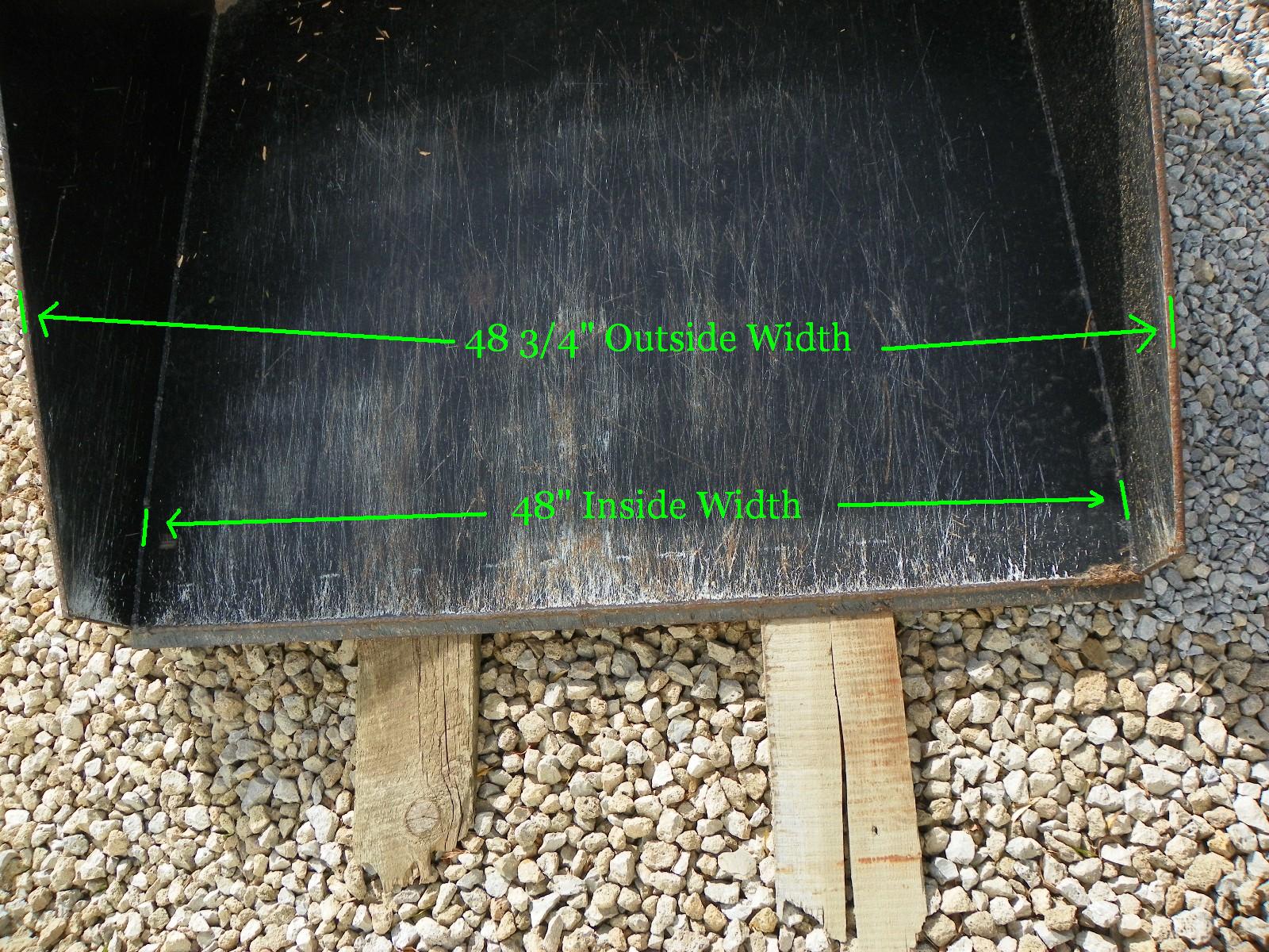

    This is project 2. Well to be able to load mini pickups and crew cab trucks with those short and shorter boxes a 72" Deere bucket just doesn't cut the mustard! You end up with about 2/3 of your bucket in the truck, the other 1/3 in your beautiful driveway rock.
    What's the solution!? A custom made bucket!
    Your normal 72" bucket holds roughly 3/4 of a yard of mulch leveled in the bucket. This custom made mulch bucket is easier to crunch numbers, whereas you just barely heap the load and it's one cubic yard.
    We cut out the quick attach plate. And welded this bucket up. We had the two sides and bottom sheared at our local steel shop. All the metal is standard A-36 rolled.
    Here's the lock bracket
    Height of quick attach plate
    Width of quick attach plate
    Dimensions of bucket picture 1
    Dimensions of bucket picture 2
    Picture of "cutter bar", "wear bar", or "cutting edge". We plasma cut the bevel on the bar. (SuperCut 50, never hit the duty cycle. Was running full 50 amps for about 15 minutes, the temperature was around 55-60 degrees inside so it was running cold).
    Extra picture
    Dad painted it with John Deere "Black" and John Deere "Yellow" to match the loader it goes on
    If you want to build one of these or are interested in more information, feel free to ask your questions here.

    Nice build, I like the way you show dimensions, very useful,
    Thank you Geezer
    So if you had a mind to build one of these....what would you need for extra info? I covered basically everything I could think of as far as dimensions and plenty of pictures..
    ILP
    The pics do a great job all by themselves, the only thing I am curious about is how it is attached.
    The only thing I am curious about is how it is attached.
    I'm guessing you mean attached to the loader? I can shoot a quick video

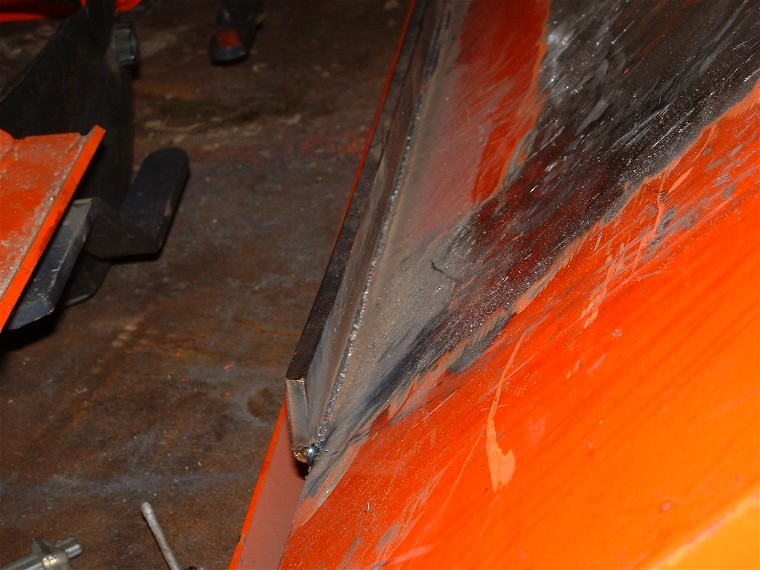

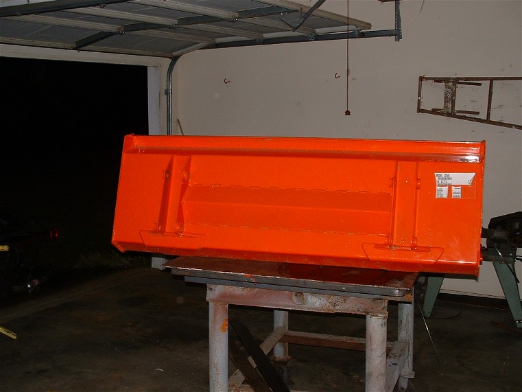

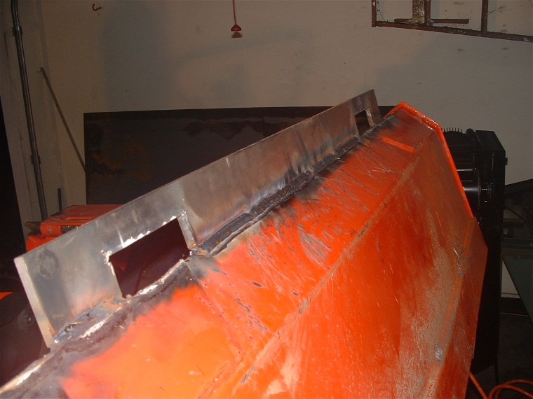

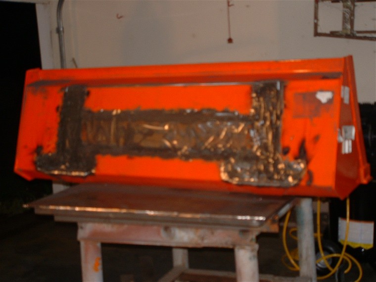

    I have done the same thing for a tractor dealer, converting his older Kubota stock buckets to quick attatch. Heres a few of it in progress. CAn't find the finished product though.

    Thanks, I just wasn't familiar with that type of quick attach.
    Yeah it's pretty new I think we've had quick attach for about 5-6 years...sure beats the 3" roller pins we have to drive out of our Massey Ferguson wheel loader bucket to switch to the forks. About an hour and a half and couple hundred cuss words from dad later we got it...
    Looks real good Mark. So I'm curious how did you go about removing the factory brackets? Grinder or plasma...????

    I used both plasma and oxy acetylene.
