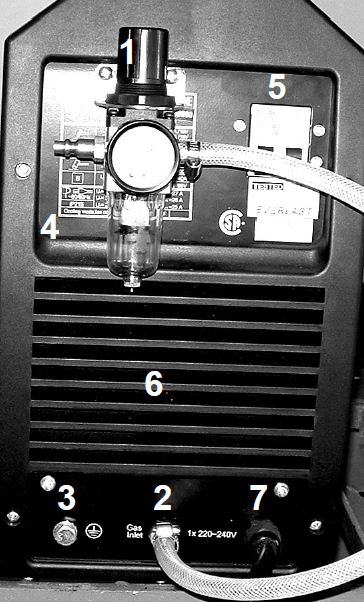

    If you mean the gas inlet at the back of the machine, it's a 5/16" hose barb and I don't think it can be changed.

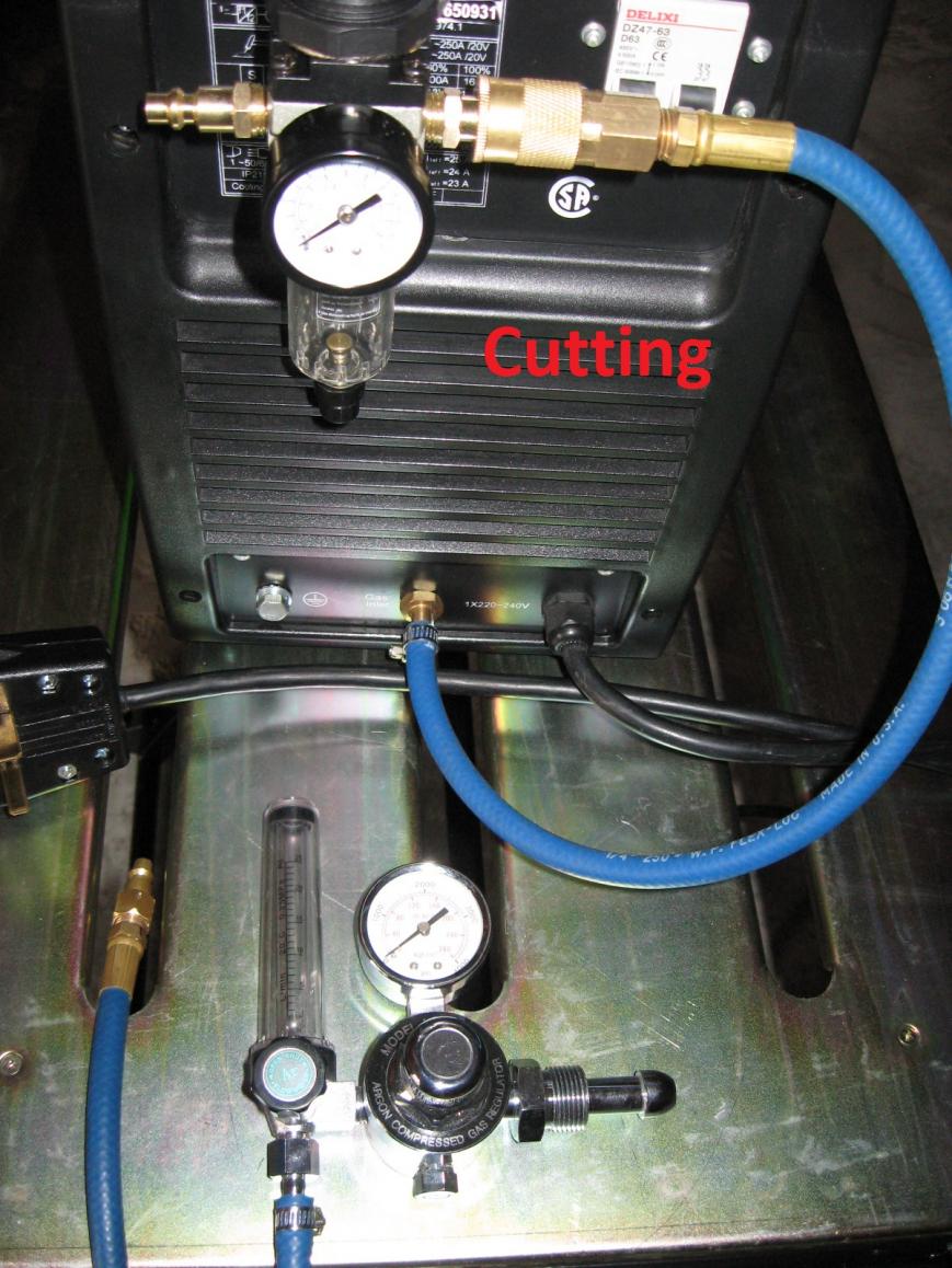

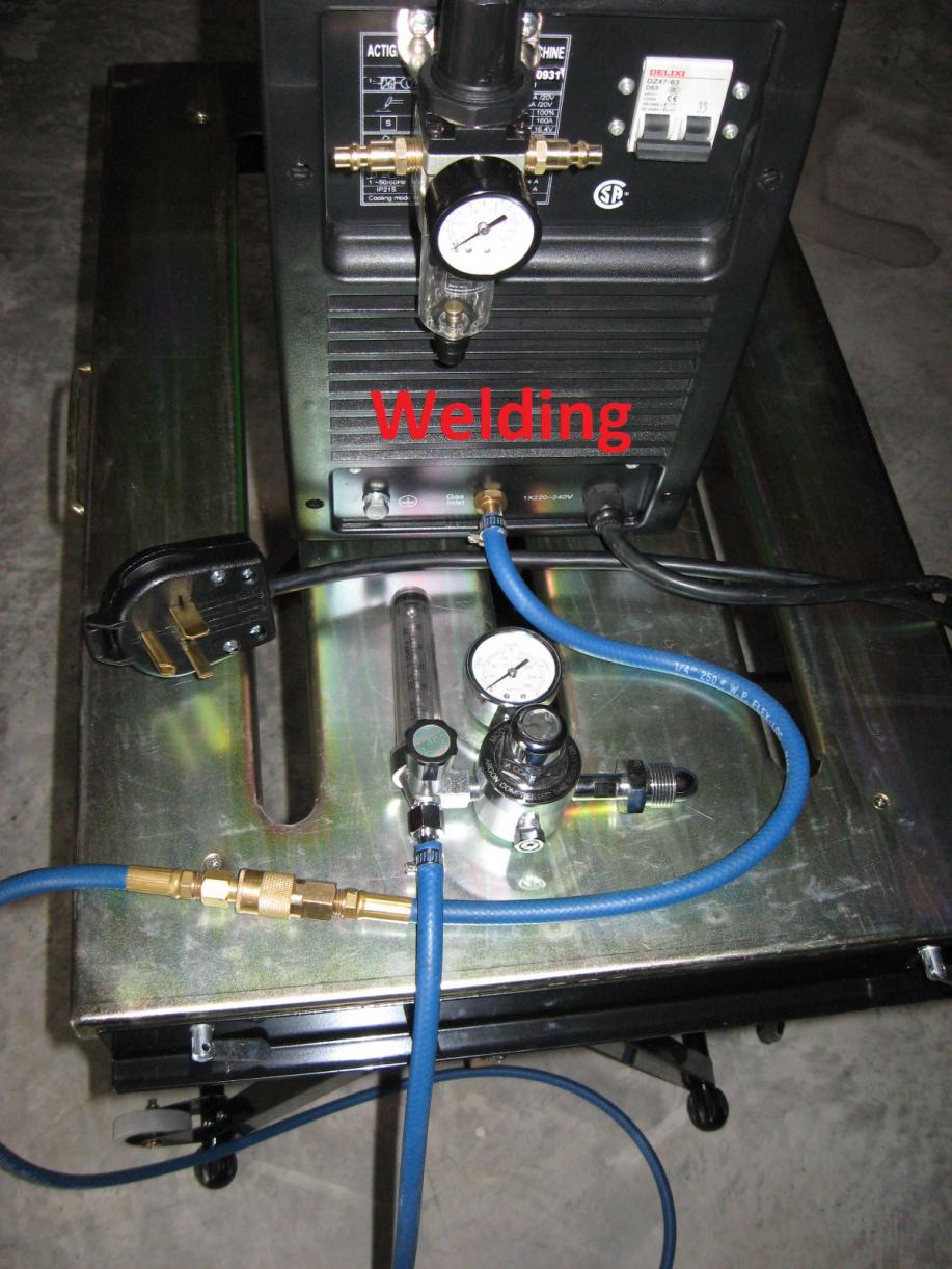

    I cut a 10' standard 1/4" pvc air hose (made for use with air compressors) and put about 16" of one end on the air/gas hose barb with a standard 1/4" NPT female quick coupling.
    I put a 1/4" NPT male quick coupling in each side of the air pressure regulator that mounts on back of the welder and attached 6' of the air line to the gas flow regulator at the argon tank with a 1/4" NPT male quick coupling at the free end.
    To use the plasma cutter, I connect my shop air line to the inlet side of the air regulator mounted to the back of the welder. To weld, I disconnect the air/gas inlet quick coupling from the outlet side of the regulator and plug the line from the argon tank directly into the /airgas inlet.
    It takes 10 seconds to switch the lines and no valves are necessary.

    Your pic is of the front panel where the air/gas connect to the plasma or tig torch with a small quick coupling. I added pics to my first post for clarity.

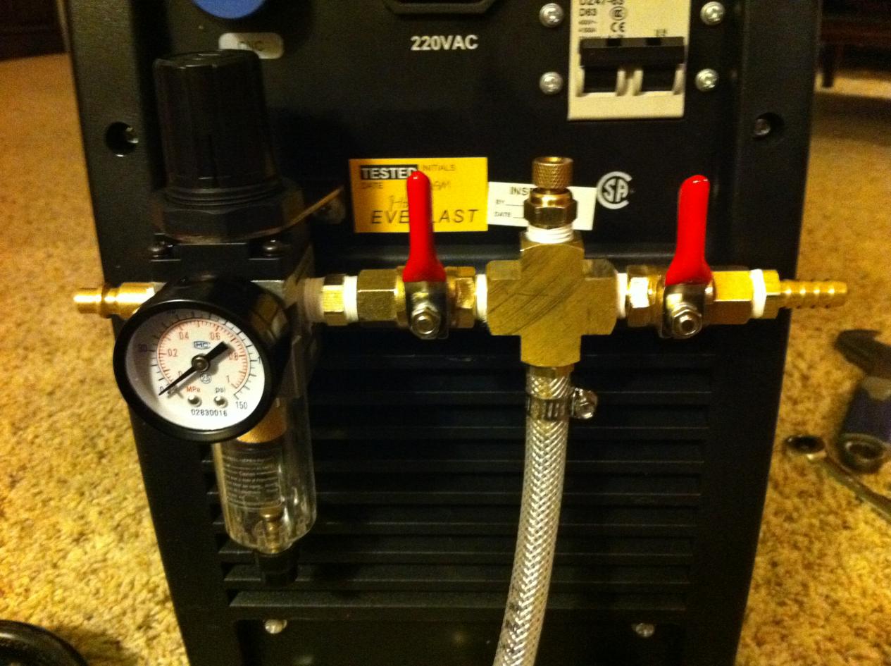

    I thought I would throw add a pic of my valve setup here ... I found a 1/4" FIP cross at the Parker store, which helps to keep the setup pretty small. This is the same as Tom's setup, but the cross let me add a bleeder valve to release the pressure.
    Cheers
    Mike
